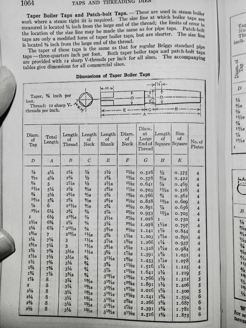

Hello: I had hoped my 1919 Machinery's Handbook would have thread data for the 12tpi tapered boiler threads, unfortunately it did not, but there was a page of data for standard sized taps. This may be of some use to the original poster or others searching the topic. By using dimensions "D" and "B", and the taper of 3/4" per foot you can calculate the OD of the tap at a point about one plate thickness back from the end of the tap, that should be in the ball park of the right tap drill size. By the way the "Briggs standard pipe" taps mentioned in the text seem to be the same as the modern day dry seal National Tapered Pipe standard.
Pat Hosford

Thanks for the graphic. That is the kind of info that satisfies my mental itch to know. I had to ask the Steel Institute in Pittsburgh to research early 20th century steel catalogs to get the profile for the channel Climax used for the frame - no longer made.
