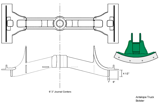

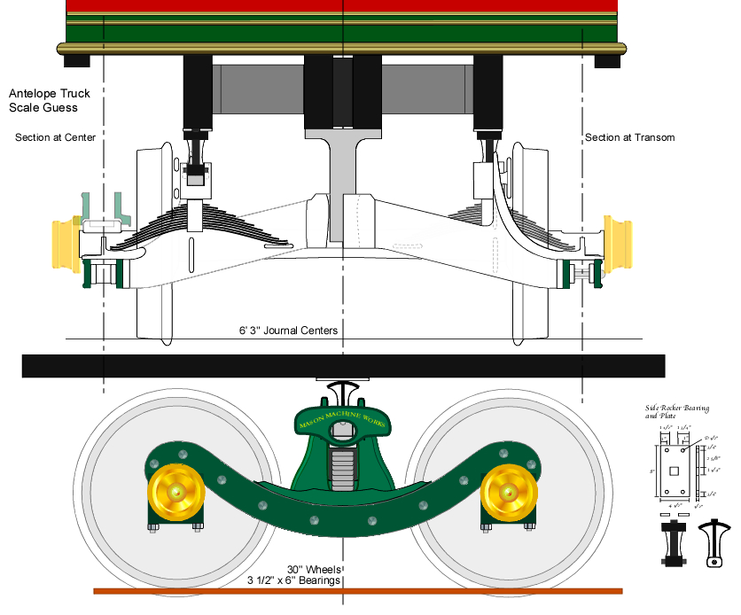

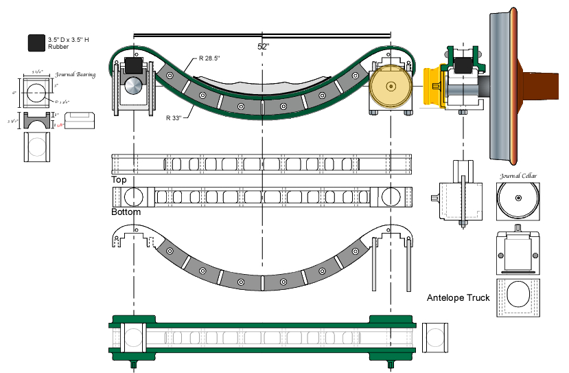

Resurrecting this thread re: the OP question. Has anyone else found anything on these curved frame trucks? I have searched the patent records, as many old periodicals as I can and not found anything more than a few more pics, some more helpful than others.
As near as I can tell, these trucks were only built from about 1866 to 1869. I have not found anything to indicate otherwise, and it seems like they disappeared altogether rather quickly, probably for the reasons stated below. I decided to scale the pics I could find and take a stab at reverse engineering them, taking into account the casting/machining abilities and other designs of the time. The drawings are not complete - there are some details like the shape of the inner spring landings and rocker link boxes that I didn't take time to finish - just conceptual at this point.
It appears they were meant to be a very minimal/simple design, but still there's a bit to them. The problem seems to be they look nice, but the design is quite flawed. If I'm reasonably correct, the flaws include; way too rigid, not capable of carrying heavier loads (without making them even more rigid and way too heavy and consequently not as aesthetically attractive), a maintenance headache, non-standard compliant (which wasn't much of a concern when they were designed), and probably too fragile as they approached their load limit. They appear to use a four-point suspension with rocker links above the springs. There are several other designs from around that time that share certain design characteristics like the rocker links and center pin, including from Hinkley and Baldwin as shown in the 1871 Weissenborn book. Side frames appear to be a riveted sandwich of three castings, also riveted to the one-piece bolster. The only add-on pieces would be the spring bundles, rocker group and binder/cover/name plate, and the journals/cellars/wheelsets. My version of journal is probably more guess than reality - they were probably more of an earlier Winans style like on page 301 of White's American Locomotives. Brake rigging was frame-hung, so not shown.
In any case, here are a few scale sketches based on the available photos. If anyone knows what happened to Wallace's Mason collection, there's a side-on photo of Highland Light c/n273 would be helpful if a hi-res scan were available.
And no, the colors are probably not correct for Antelope - they were suggested by a litho of Highland Light....
G.
