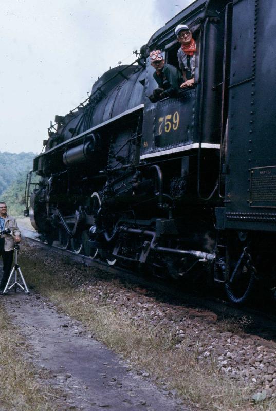

Ross - you don't have to have a Facebook account to view a public group. Just click on it and scroll down. I'm in your age bracket and have figured it out. BTW, I have great memories of my 1st railfan excursion in 1970 from Harrisburg to Horseshoe Curve and back behind 759. I think you were the engineer weren't you? Anyway, I copied the post and will paste it below for you and other Luddites.

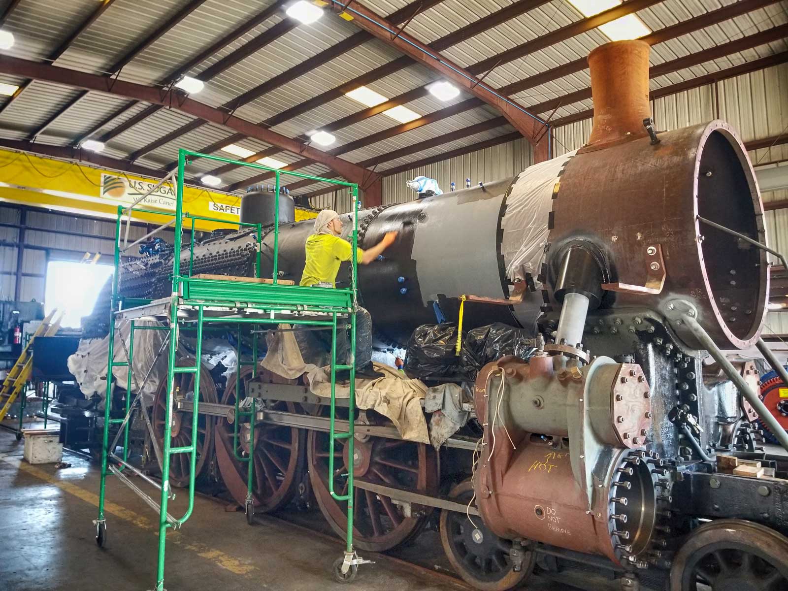

PostPosted: Thu Nov 07, 2019 4:47 pm
Posts: 2651
Updates:
https://www.facebook.com/EngineNo148/ph ... =3&theater
Caption to this photo: "Engine No. 148 is being coated in Thurmalox, a formula designed to withstand the 370-degree heat of the boiler, while also protecting her from moisture and condensation."
