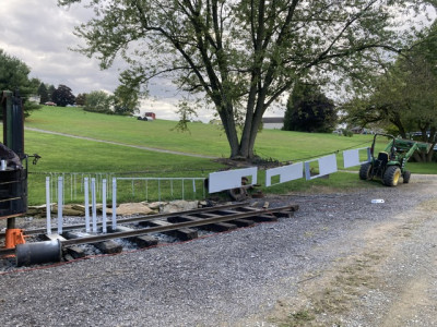

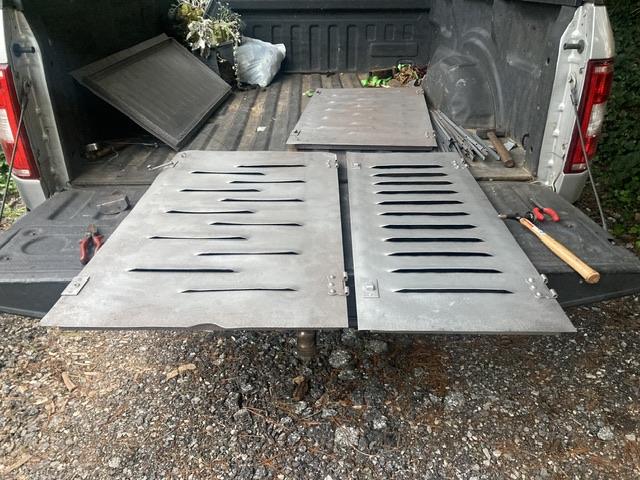

Got some parts primed today. Amazing how many square inches even this small locomotive is.
Here’s my ‘free range’ paint booth. Rudimentary, but getting the parts sealed in epoxy primer and ready to top coat.
The blast shop sent some of the louvered hood doors through a machine that was a little too aggressive. Not a big deal, but some of the panels and louvers are bent. Had to get at it with a hammer and dolly. Left is before, right is after.

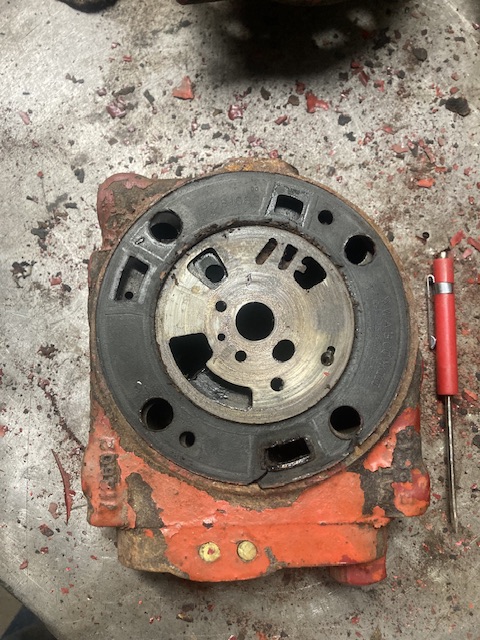

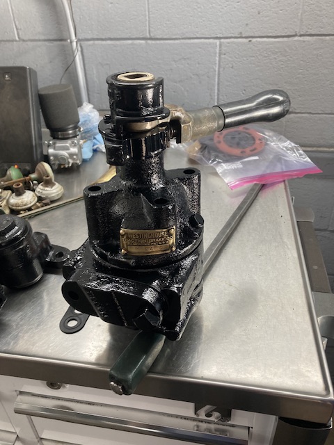

I need to be more self sufficient in regards to rebuilding brake valves. Figured I’d start with my own stuff in #6. Best to learn on your own equipment, right?
Here’s the brake stand, I have a contact in to my local shop and, hopefully, they can sell me the proper gaskets to complete the job. It’s a Westinghouse AMM system and the brake stand is an M24C.
Strange system. Has one brake handle that operates the independent and the automatic at the same time. No idea how it operates, I’ll learn more once it’s aired up and I make some valve moves. Looks like you switch a valve for running light or running a train. Either way, I’ll make sure it’s understood and safe before operation.

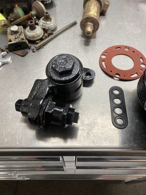

The gasket and seal order showed up today.
The feed valve and brake stand are ready to go. Two more valves need service. A triple valve, and I believe a double check valve. Will learn more about them when they are apart.

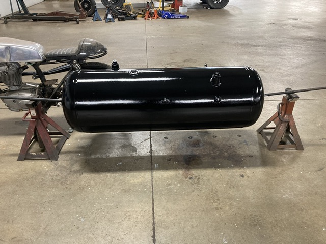

Got the fuel tank primed today. Check out my low budget rotisserie!
I’ll get the black topcoat on it tomorrow.
I’m starting to second guess myself on the drive chains. I spent a bunch of time, all documented on this thread, to get them together. That fact is, I still don’t trust that they’ll give me a long service life. The Loco is still jacked up right now. Will be a perfect time to install New chains and adjust the axles. Better to do it now than later when it’s in service. I’ll keep the old chains for spare parts.

Top coat is on. I’ll wait the 7 days until it’s fully cured, then install the tank on top of the transmission.

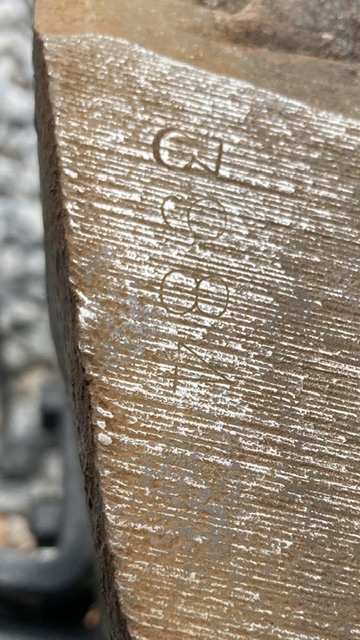

I did some needle scaling and found the Plymouth chassis number. I was always only 99% sure that this was the real Little Mo. Maybe I’m skeptical?
I know this is the Plymouth that was at Edaville. I found that paint scheme under the green topcoat. Was never 100% sure that Little Mo went to Edaville after Wolfeboro had it as their #9.
Was great to finally find out for sure. #3984
Looks like it’s the real deal and I was worried for nothing.
