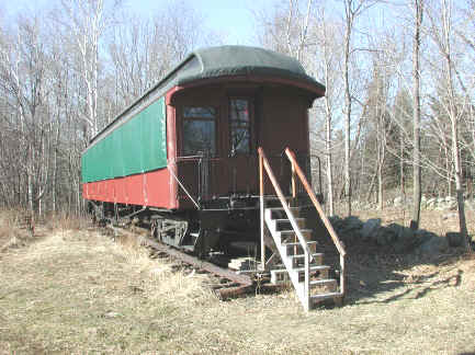

I had never done anything with the platforms and railings at each end. Although I had very early on rebuilt and painted the steps, I had spilled paint remover on them in the course of stripping the paint from the ends so they now looked rough at best. A lot of the old revenue service paint had weathered off over the years in the more exposed locations although there was plenty left. I don't know how many coats were there, but there were plenty and it had turned gummy and cracked with time. The only thing that worked was heat.
That was fine for the areas far from any wood, like the railings, but more difficult as I approached the platform near the wood body. I was able to use a hand held propane torch successfully on the safe areas and since the grass was soaking wet, the flaming gobs of paint that fell there were no problem. On the more sensitive areas, I used my heat gun on low heat and that worked OK. The paint wouldn't come off as neatly as over wood, but sort of melted off and reattached in a thin layer.
This actually was not as bad as it sounded since it gave me a '"free" first coat for when I repainted. I was disappointed at how long it took to strip the paint off considering the small square area involved. It was like working on a picket fence, all kinds of nooks and crannies so you didn't make much forward progress. Repainting was as slow for the same reason. Give me a nice flat surface to work on anytime. Repainting the steps seemed like a picnic in comparison.
In addition to that project, I needed to build a set of stairs up to platform. Why I hadn't done it years earlier is still a mystery. Ever since I first rebuilt the steps in the first year, I had been laboriously swinging myself up from the ground which made it really hard for anyone to visit and really hard to carry any tools aboard. Perhaps I just didn't want to devote the time to it or didn't have confidence in my stair laying out abilities. Anyway it was now obvious that it would have to be done.
Stairs aren't something you just knock together. There's a sort of science to it. The combined total of tread and riser has to be to a certain figure which my home handy man book doesn't give, but which I estimated at about fourteen inches. The angle of the stringers have to be such the stair risers are all the same height after the treads are nailed. This means you have to know the vertical rise and plan ahead so you don't have a half step at top or bottom. Calculating the vertical rise to uneven ground a number of feet out from the platform is no easy trick.
Photo by David Woodbury.
The new steps, side curtains and a corner post in need.
I found that the easiest way to cut the notches in the stringers would be to make my angle forty-five degrees and did so for this reason. Only after the whole thing was completed, did it seem that this was a little steep. All in all, the project was a success with this slight exception. At last I could run up and down and actually carry stuff around. This was all to the good since I had a lot of cleaning out to do after years of accumulation all of which had to come out before I got down to serious varnishing.

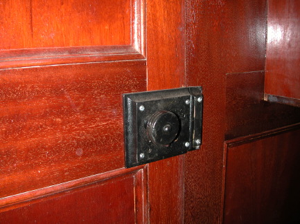

Sometimes things work out right. I had hung the doors for the saloons on modern brass plated hinges since I had none of the older style and didn't really know what they looked like. I knew that I would have trouble finding the correct style of rimlock for those doors although I knew what they ought to be from the Pullman specs and those still on the restored coach at the Lowell (Mass.) National Historic Park. The B&M must have had a special relationship with a Boston manufacturer named Sherburne since a number of items, including both outside and saloon locks were specified to be from that outfit. The outside locks were of bronze and I had one of the right type but the second was a caboose retrofit. Of course, the saloon doors were long gone along with the partitions which I had to remake a few years ago. I had pretty much decided that modern replacements would have to do or find some older latches at an antique hardware place.

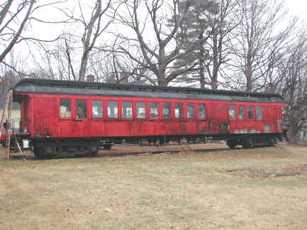

As luck would have it, another car turned up in Lunenburg, Mass. Ex-B&M 1286 a Laconia product had been sold as surplus by the B&M in the 1970s to a buyer who moved it to his property in Lunenburg. During his lifetime it was never restored and became a catchall for all kinds of stuff. Of course, it suffered from neglect over the years as well. After the death of the purchaser, his family sold the home with the car and the present owner, not a railfan, but aware of the historic interest the car possessed agreed to give it to the Old Colony and Newport, a volunteer operated scenic railroad in Newport, Rhode Island which already operated two wooden coaches.

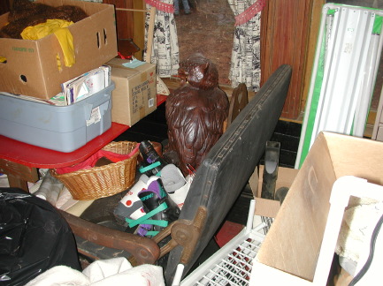

I saw the coach interior with personnel from OC&N and noted that there were some real gems still left inside. These included a couple of correct style flip-back seats which OC&N plans to use to replicate others. The two saloons had been ripped out years ago, just as mine had, but a crude enclosure for a chemical toilet had been built in the middle of the car against some blocked off windows. By the greatest luck, the original saloon door with all hardware was taken from the women's room and reused here.
Saloon rimlock as I found it in Lunenburg, MA.  All photos by David Woodbury.
OC&N had no plans to replicate the saloons when they put 1286 into service so I begged for the door and hinges and most importantly, the latch. They graciously agreed and I took the door and hardware. I want to thank them again publicly for their generosity. I had no plans for the door itself, but I could most definitely use the hardware. After stripping the lock, I found it was a Sherburne #53 marked specially for the B&M. As such it would be keyed alike with the outside doors. The hinges, which had never been exposed to the weather, retained under layers of paint, their original japanned black finish. I was able to find a second set of the correct style hinges for the other door, but I'm still looking for another Sherburne #53. Not that I'm that hopeful.

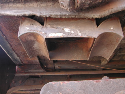

Now was the time to think about cutting the holes for the hoppers. Before doing this, I checked under the car to see what guidance I could get from whatever remained from before. There is a cute little venturi under one end that gives a clue as to where to cut the hole. Unfortunately the venturi doesn't line up with the hole in the sub-sub floor so this interesting misalignment must have created some problems for the car maintainers who had to clean up after each run. Another interesting aspect of things was the fact that the frame of the truck was under the hole. If not directly under, at least enough to cause a problem on curves, oh well.
