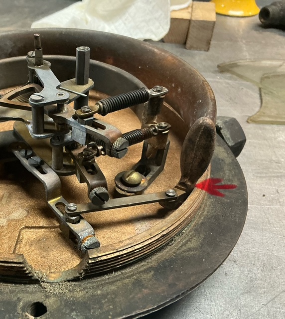

I think the big issue with making repairs will be the integral Bourdon tube. Unlike the Ashton gauges I've worked on that have a bolt in Bourdon tube assembly, this Ashcroft gauge has the Bourdon tube soldered into the case base casting.

No hope of it operating as is. The free end of the large Bourdon tube is pinned up against the case. With no possible movement under pressure the black needle will be unable to move.

And note the way the big tube is twisted and captured by the gauge case. It wants to spring out even further.
