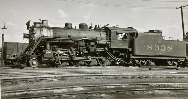

Gentlemen,
I am writing an article for TIES magazine (the journal of the Southern Railway Historical Association) on the development of Southern's K, Ks and Ks-1 Class Consolidations (such as survivors Nos. 630 and 722). Some of these locomotives were equipped with Worthington feedwater heaters in the 1940s, but I am not clear as to which one(s), though I think it was most likely the SA and SCA2 systems.
There are some decent photos of these locomotives (attached) and I have found the cover for a Worthington maintenance manual online (but no scanned text). I am hoping someone may be able to identify which system is used in the photos and might even have some scanned Worthington literature he would be willing to share.
Can anyone help?

8338 and 6920 have Elesco FWH systems, with the more modern coil style heat exchanger located ahead of the stack.
6907 has a Worthington S-type system, with the hot water pump on the pilot and cold water pump under the cab.

Howard,
Thank you for pointing out the Elesco coil type feedwater heater on both GS&F Ks 8338 and NO&NE Ks-1 6920. I suppose that big oval box ahead of the stack is the give-away, along with the typical Elesco pump mounted beneath the running boards. That pump appears to be visually about the same as those used with the Elesco bundle type feedwater heaters.
