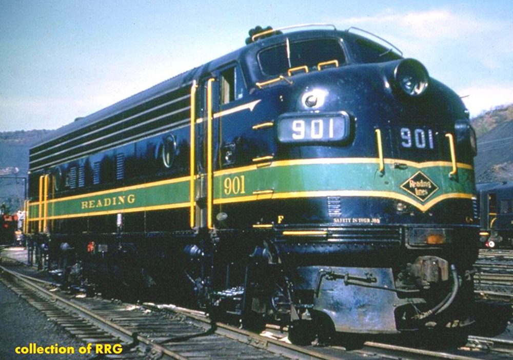

Even better, Woodfield Green is definitely not 1317. LOL This is what it's supposed to look like...

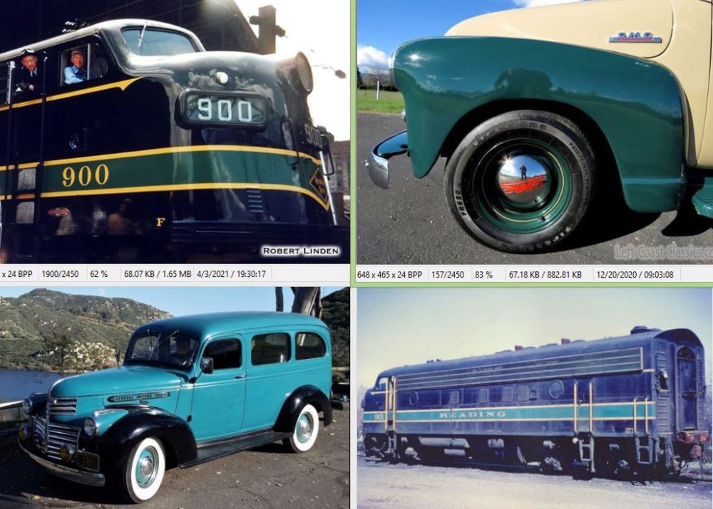

PostPosted: Sun Oct 22, 2023 11:42 am
Posts: 1400
Location: Annville, PA
Then, the Reading's original factory cab loco green would have be the equivalent of GMC Narva Green...

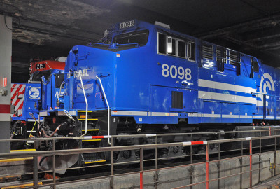

The Metra out there in Chicagoland uses WE5802 Blue. On PaintRef, it's the dark blue listed for North Suburban Mass Transit...
https://paintref.com/cgi-bin/colorcoded ... IL&rows=50
This color is also listed for the Lehigh Portland Cement Company. Those three blues may all be identical but with each of the Big Three's individual corresponding code numbers...
https://paintref.com/cgi-bin/colorcoded ... ny&rows=50
Conrail painted their step edges white like the Metra unit. That yellow kind of throws the whole thing off, huh?... LOL

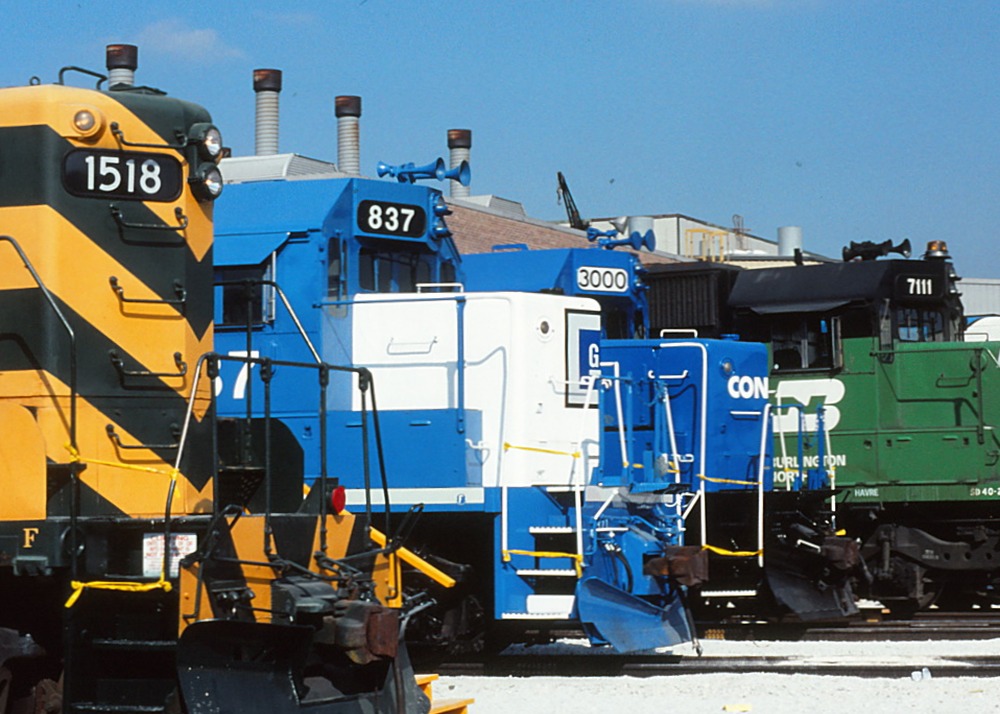

General Motors WE5802 Blue is slightly darker than DuPont 77257 Blue, the EMD demonstrator color, and this picture taken at the 1989 factory open house pretty much confirms what I'm seeing here first-hand with the samples...

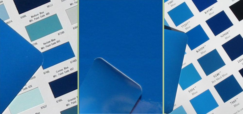

An early-seventies DuPont Fiat paint chip sheet arrived here on Wednesday. General Motors WE5802 is the equivalent of DuPont 8748, Fiat 497 Cannes Blue or "Blu Cannes" in foreignspeak.
On the left, we see the matchup between GM WE5802 and DuPont 8748. In the middle is the comparison between WE5802 and the current paint on Conrail #2233 at the RRMPA. On the right is WE5802 vs. the modern Imron-era version of this color, DuPont/Axalta K9359.
Here it is on the Northstar site. An alternate code number for K9359, and currently used by Axalta on their website, is N1728.
http://www.mixmaster.biz/v_formulas/Sys ... code=N1728
This is actually a fairly decent demonstration of how this color has shifted slightly over the years. There's 77257 Blue directly above K9359 Blue. 5240 Bright Medium Blue is the former 1032 Federal Truck Seafoam Blue and 7165 Blue, the former 3430 Chevy Truck Export Blue...

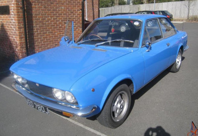

Conrail Blue is now officially listed on PaintRef. It wasn't before...
https://paintref.com/cgi-bin/colorcoded ... rp&rows=50
Ditzler/PPG calls this color Bright Blue or Mediterranean Blue. In 1975, Fiat introduced a different color called Mediterranean Blue with the factory code of 487 so beware of that because, well, it's not the same.
The Martin-Senour number I have for General Motors WE5802 is 11536.
Maritime-Ontario in Canada uses the same Dodge Truck code as Lehigh Cement, DT8488, leading me to believe we'll find Conrail Blue up there as well...
https://paintref.com/cgi-bin/colorcoded ... +Transport
https://duckduckgo.com/?q=maritime-onta ... &ia=images
Anyway, the older pre-Imron version is somewhat less vivid, slightly lighter, and perhaps tinted a bit greener...

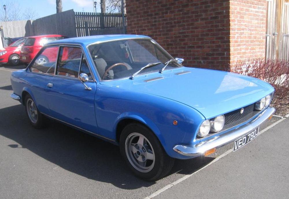

Back to Conrail Blue, everything we've seen here seems to jive with the Trains article concerning the color. Toward the end, they were using a two-stage Imron system...
https://cs.trains.com/trn/b/staff/archi ... -blue.aspx
In the big binder full of Imron, the 5000 line is single-stage and the 6000 line is two-stage.
This 1969 Fiat was repainted in a modern two-stage system...
https://smclassiccars.com/fiat/561201-g ... style.html
Around and under the "hood", we can see both the old and the new...
