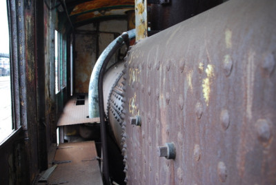

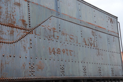

The rotary in question is LIRR 193, Cooke 11-1898, before PRR control. At some point it got a PRR tender and seems to have a Belpaire firebox, (see Scranton Yard's bottom photo.) This may also be a replacement.
Long Island (the island and the Rail Road) is directly in the path of Atlantic Winter Storms so LIRR did have use for a rotary.
It's currently unrestored at Steamtown.
