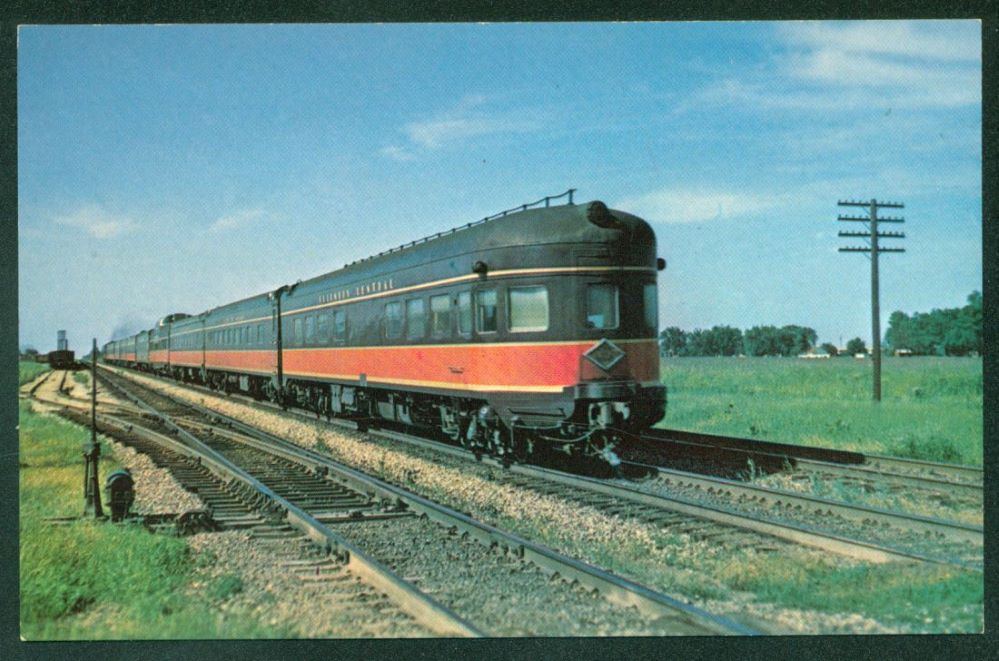

I recently became aware that some lightweight cars were outfitted with a GSC lightweight truck in 6-wheel arrangement. A car body that I know of which used them, and probably still needs them, is the Illinois Central "Gulfport" at Monticello. Is even one set of these trucks around in preservation?

I only was able to find one in-service photo of the Gulfport (IC 3312) and it looks like the truck on the tail is 4-wheel. https://www.flickr.com/photos/john_stev ... 5968134837 Edit: I also found the top photo of the Gulfport, but it is hard to see at that angle.

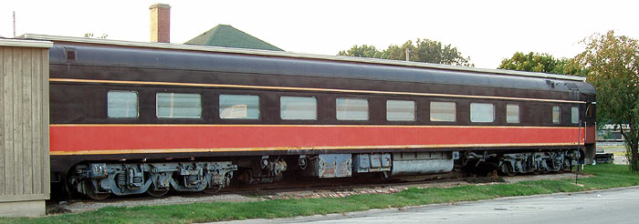

The car below may be a lightweight car (or then again could be a modernized heavyweight car) is painted for IC and has six axle trucks, it was part of a restaurant at the Lincoln IL former GM&O station, but was donated to Iowa Pacific, who then let it be vandalized, and I think it was eventually scrapped. I am not sure of the number:

Don't know what your source is for that information regarding Gulfport, but it was, along with the rest of the new equipment built in 1942 for the new, streamlined Panama Limited, built with two-axle trucks.

However, ICRR did extensive car work at their Burnside Shops in Chicago, taking many, many old heavyweight cars, stripping them to the center sill, and building new carbodies on the remaining frame, resulting in a first-glance appearance of a lightweight streamlined car. The cars were still heavy, so re-utilizing the three axle trucks was necessary, and those too were modified with roller bearings, bolster anchors, and truck mounted brake cylinders/slack adjusters for satisfactory use at ICRR's 100+ mph speeds between Champaign, IL, and Branch Jct., just north of Centralia, IL. Maybe photos of one of those with a round end has someone confused?

I suspect that the observation is IC 3320, "Paducah" which was rebuilt from heavyweight coach 2173 for the Louisville - Fulton of the "City of New Orleans". The window pattern matches that of 3320 which was originally a "coach-lounge-observation". It may have had an interior reconfiguration after this service to make it a full lounge. Further, I would guess that the train that it is on is the "City of Miami" with a repainted NP dome sleeper and a stainless steel car in the consist.

"However, ICRR did extensive car work at their Burnside Shops in Chicago, taking many, many old heavyweight cars, stripping them to the center sill, and building new carbodies on the remaining frame, resulting in a first-glance appearance of a lightweight streamlined car. The cars were still heavy, so re-utilizing the three axle trucks was necessary, and those too were modified with roller bearings, bolster anchors, and truck mounted brake cylinders/slack adjusters for satisfactory use at ICRR's 100+ mph speeds between Champaign, IL, and Branch Jct., just north of Centralia, IL."
Many of the IC heavyweight rebuilds received all-new outside swing hanger three axle trucks, such as is seen under the car in the picture that was part of the restaurant.

thanks for correcting my info on the car at the Monticello Railway Museum.
Sorry, my source for the reference to Gulfport must have been a badly characterized postcard on Ebay. The car in question on this image is 3305, probably a converted heavyweight. I think it was later owned by Iowa Pacific.

[quote="o anderson"]thanks for correcting my info on the car at the Monticello Railway Museum.
[img]https://external-content.duckduckgo.com/iu/?u=https%3A%2F%2Ftse3.mm.bing.net%2Fth%3Fid%3DOIP.Zt118uduhvAh9eED-C8O_AHaFj%26pid%3DApi&f=1&ipt=98dd38099cad364f5ff37ecc4fb4773bb70e8850b584e414c6141974c8703442&ipo=images[/img][/quote]
I don't believe that the car initially pictured in this thread is 3305. 3305 has five windows in the rear observation and lounge portion. The car pictured has six windows which was the window arrangement in "Paducah". Of course, it is possible that one of the windows could have been sealed over.
