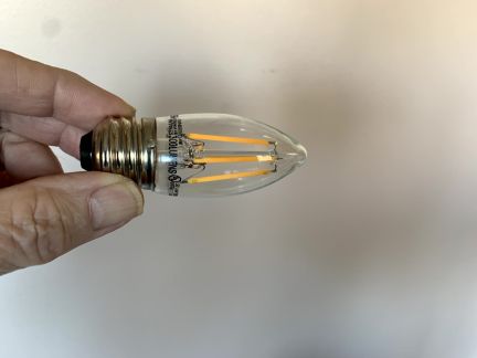

Brian - these are the two styles I use, both have the standard base:
