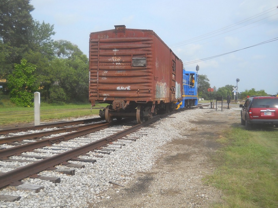

Happy to announce that Chicago, Indianapolis & Louisville (Monon) 40' steel boxcar arrived yesterday at HVRM. Brought in by truck, the car was unloaded at the east end of the museum just off of Main Street in North Judson. At the end of the days operations, the museums 95-ton G.E. diesel is shown below, pushing the car into HVRM's passing track.
The boxcar was originally part of the Indiana Transportation Museum's collection that was stored in a pair of sidings, north of Noblesville. That equipment was eventually moved to a non-rail location in Logansport and then recently, saw much of it being scrapped. Monon boxcar # 1220 however, had been privately purchased and with "SAVE" marked on both sides and both ends, finally made it safely to Hoosier Valley.
Plans are to eventually repaint and letter it for the Monon. First however, we will get some red primer out and paint over the graffiti. This is the 3rd piece of Monon equipment that is now at the museum, joining EMD SW1 diesel #DS-50 and transfer caboose 81551, both of which are long term museum restoration projects.
Thanks to Schlatter Boys trucking, for their excellent work in getting 1220 to its new home.

Glad to see some positive news out of Indiana.
And the car looks mostly intact, including full height ladders. Any chance you'll get to put the running boards back on?

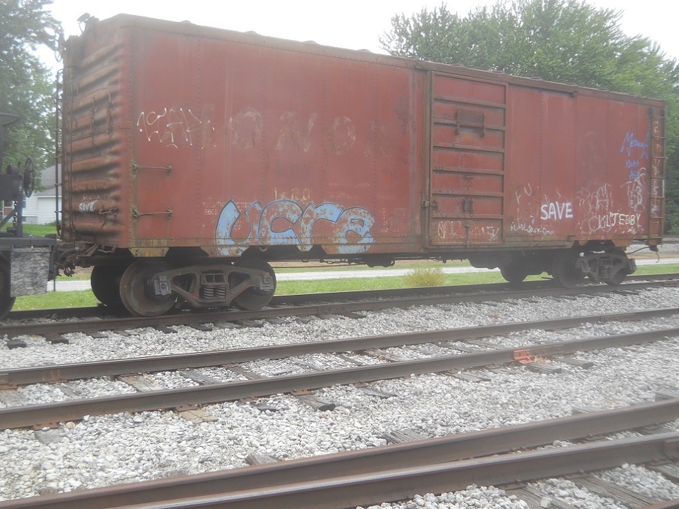

The museum is evaluating bringing the Monon boxcar over to be repainted and lettered. As you can see from the above photo, the car is currently covered in graffiti and I have now included a photo of the other side of the car, which obviously has the same problem. A typical 40' steel boxcar painted freight car red. But wait, there's more here than meets the eye!
The 150 cars of the 9000-9149 series, were built for the Chicago, Indianapolis & Louisville (Monon) in October of 1941, carrying the C.I.L. reporting marks and with the railroads old "Reliable Service" herald. But in late 1947 or early 1948, twenty five of the cars were brought in to the lines Lafayette, Indiana shops. They were given Evans DF loaders and assigned to service for the Appliance plant of General Electric in Louisville, Kentucky. At that time, the cars were given a new coat of gray paint with bright red lettering which included the railroads new "two teepees with arrowhead" logo. The 25 cars were also given road numbers 1201-1225. Our car is C.I.L. # 1220. It is this gray/red paint scheme, that HVRM wants to apply to the box car. We have been in conversation with the Monon Railroad Historical-Technical Society, and although we have received photos from them of a couple of cars from the series, none of these photos are in color. Some of the model railroad companies have produced these cars in the gray/red scheme, but we are not sure if the gray on those models, is the correct shade. We are hoping that someone, somewhere, might have taken a color photo of the cars when painted gray. The cars apparently did not last long in dedicated service and eventually ended up in general service and, beginning in September of 1952, were repainted back into red as they came into the Lafayette freight yard. C.I.L. 1220 was repainted in December of 1953 when, in addition to the freight car red paint, its reporting marks were also changed from C.I.L. to MON. The repainted cars kept the 1201-1225 numbers.
We are hoping that someone out there might have a color photo of one of these gray painted cars.
Thanks.

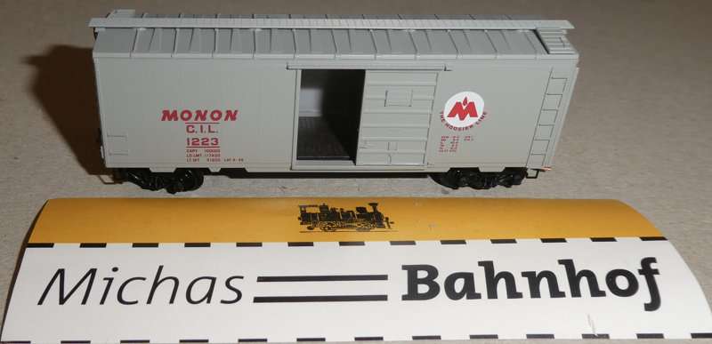

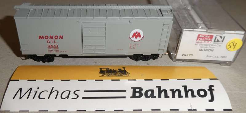

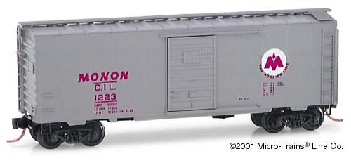

I came across quite a few models of your car series, too, here are just a few. The model companies must have access to color photos, right? Or at least one of them did, and the others just copied the first. Edit: Looks like "Micro Trains" made the 1223 model.

Thanks for the photos of the various models of the "gray/red" Monon cars. You the man!!!

So, I did some digging on Micro Trains and found out they are located here in Oregon in Talent, the town near the California border that was badly damaged in a fire last summer. I emailed them, and they kindly wrote back:
"This car was released in 2002 prior to when we first started keeping digital records of our cars. Here is all the information we have on this car. We don’t have any colored pictures, but we had notes that were helpful in determining the color. When we did the car we color matched Floquil SP Lettering Gray #270-110130. This paint is discontinued now, but can be found on Ebay."
I think this means the lettering on locomotives. The SP 9010 group might know more about it.
Edit: I checked Jayrod's list and it looks like there are several versions of SP lettering gray, but only one called "Lettering Gray", dupont 54906. I'll bet there is a way to cross reference it with the Floquil number to choose the right one. No matter what, a very light gray.
