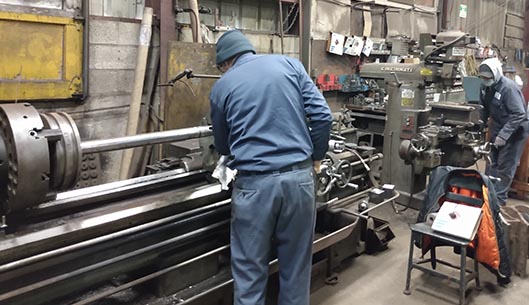

Meanwhile, back at the McHugh Locomotive shop in Pennsylvania, one of the piston rods in being polished in the lathe and a driving box is getting some attention in the milling machine.

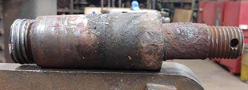

Here is a little glimpse of what has been happening with Audrey. I've been really busy and not been online very much or i would have posted something sooner.
Here is a new spring hanger pin compared to one of the old ones. All of the pins have been machined and are ready for installation.

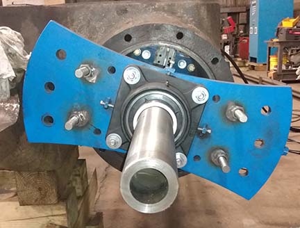

The latest work underway on Audrey involves boring the cylinders. I hope to post more in the near future.
