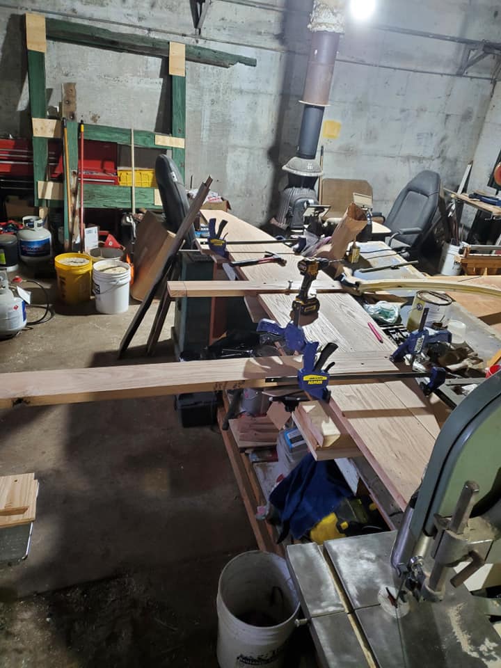

Location: cheyenne
New cab progress at the Vintage Rails Restoration 'silo' in Cheyenne, front cab is on its way to being assembled.

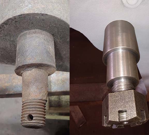

Posts: 2599
Location: Faulkland, Delaware
I've not not posted anything in some time. A lot of parts have been fabricated and are sitting aside waiting to be installed. Here is a before and after photo of the pins through the frame that the brake rigging hangs from. The way I took the photo and the cropping distort the view a little, rest assured that they are right.
