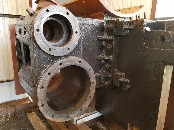

Left side cylinder after the first round of cleaning.

Don't sweat the relatively small amount of pitting in the bores. Hone them out with clean oil, let the rings run back in and they will do everything you need them to do. Rings can be expanded by peening them around the OD if you think they are a bit loose. The valve rod - make a new one in the lathe.

Do you have any ideas as to how I can hone the 15" cylinder bore without spending a fortune on purchasing a hone that size?

Get the McMaster expandable hone set, stone and wipers, and make long pins for the spiders to suit. What you want to do is smooth the bores, not remove much material apart from high peaks and dirt. The same set can be used for the valve bores with shorter pins. It's an investment as you can use them for just about anything steam and cylindrical...... or air and cylindrical. I can't see you giving up on rusty iron after so many years as a serial preservationist.
