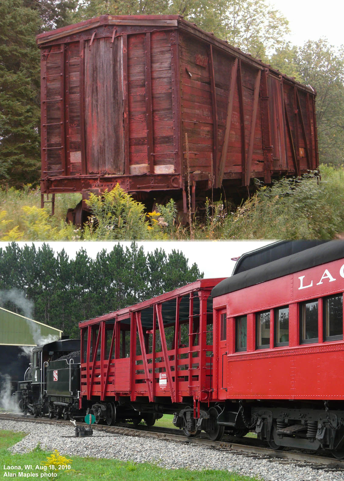

Laona & Northern Railroad (Camp Five Museum) has one, converted to an open car for the Lumberjack Steam Train.

Makes for a good looking open air car.
