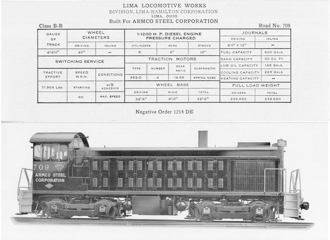

The Whitewater Valley Railroad in Connersville, Indiana is in the process of restoring its second LIMA-HAMILTON diesel into service. Work is ongoing on ARMCO STEEL CORPORATION #709, a 1000 HP Switcher. It was one of two donated by ARMCO in 1987. The second being 1200 HP model ex-ARMCO E-123 (B&O #320). These two units joined the WVRR's first locomotive Ex Cincinnati Union Terminal #25, a 750 HP model. Which is still operating today.
More information at
https://www.facebook.com/WVRRinfo/
67963533_2537147426307589_4168372318906613760_o.jpg [ 202.61 KiB | Viewed 5090 times ]
