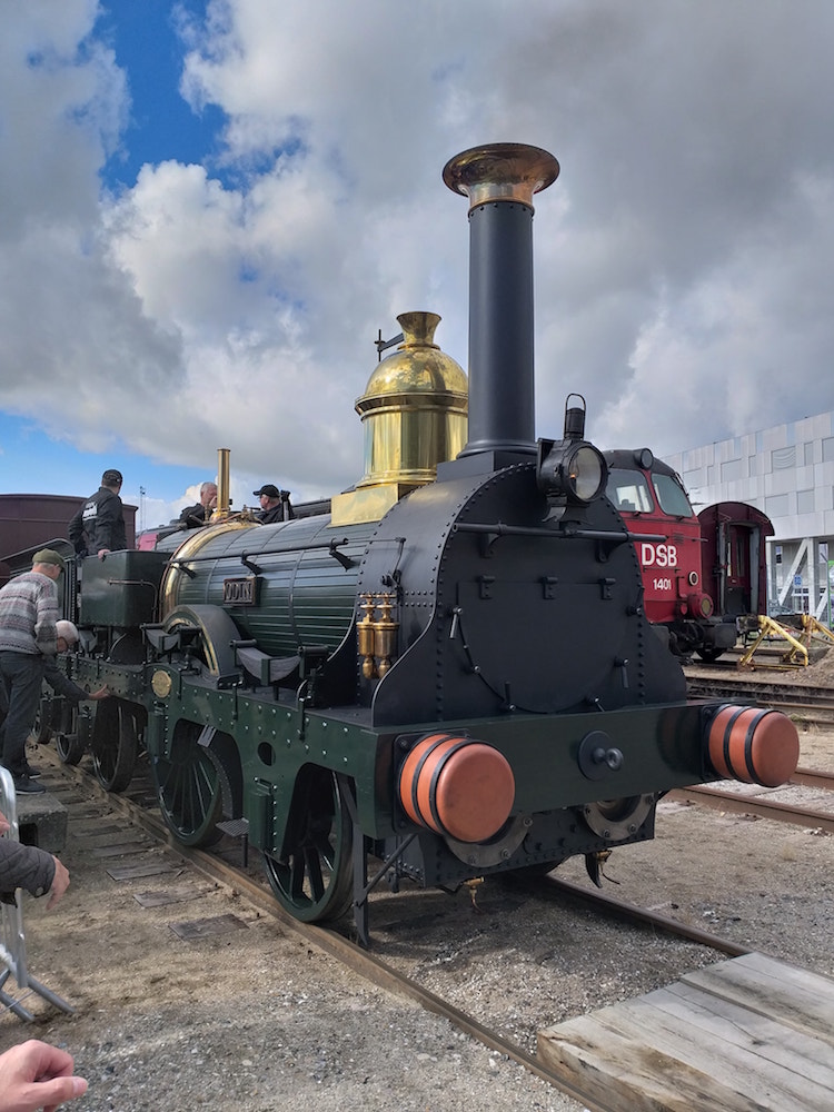

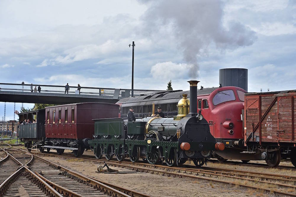

New build project, Odin, was unveiled to the public for the first time this past weekend, ending a 14 year project.
She has a few modern features, including an all welded boiler, double the operating pressure of the original (10 bar), and has a new built Worthington feed water pump hiding under the boiler. Having seen her both under construction and now alive, I can say shes impressively beautiful, and sounds fantastically strong with new D valves and any size load behind her!

Feedwater pump.... do you use any feedwater heating along with it? Seems that with twice the heat in the steam you could make some good use of the exhaust apart from making nice chuffing noises. It's a beauty, BTW.
