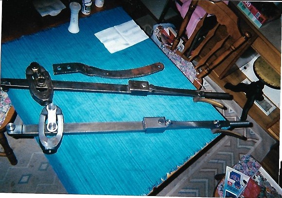

Here is the MEC #519 throttle on the top and the nearly completed reproduction that will fit #501 perfectly on the bottom. The toothed quadrant that allows the engineer to place and lock the throttle into a certain spot is at the very top. I have the drawings that will allow it to be reproduced. Several dozen individual parts needed to be made from scratch. Brass castings were made & machined. The throttle yoke needs to be reamed to fit the throttle pull rod. The blackhead of #519 & #501 are situated in the same exact position therefore the copy will fit perfectly into the existing brackets on #501. A lot of work went into reproducing this item, a lot of running around and 2 trips to Scranton, Pa to deal with the paperwork in order to borrow parts from #519 and take them off of government property.
This is the perfect example of how I took the lead and made good things happen. You just don't go down to the local auto parts store & order a throttle assembly for a 1910 steam locomotive off the shelf. The retired master machinist who did the work took great pride in making this assembly. Everything was fit together perfectly.
Perhaps I need to show more photos of things that evolve around the restoration period from 1995 to 2000. I want to show some of the hack work by others that I got the blame for, work performed before I even became a volunteer.
