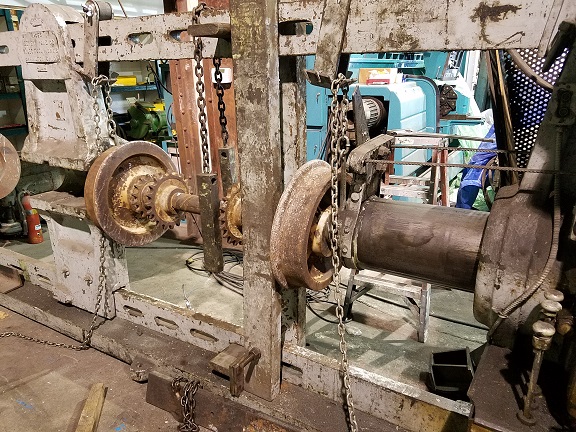

How hard was it to regauge ?

Fortunately regauging the wheelsets was rather straightforward. I pressed the wheels and sprockets off the axles, had the wheel seats and keyways extended inward 6" on each side, then pressed the wheels and sprockets back on. To make space for the wheels the sprockets connecting the axles are now outboard of the wheels on the right side.
The front running boards of the locomotive make rather handy workbenches and I have mounted a vise on the right front corner. It has proven to be a very useful addition!
