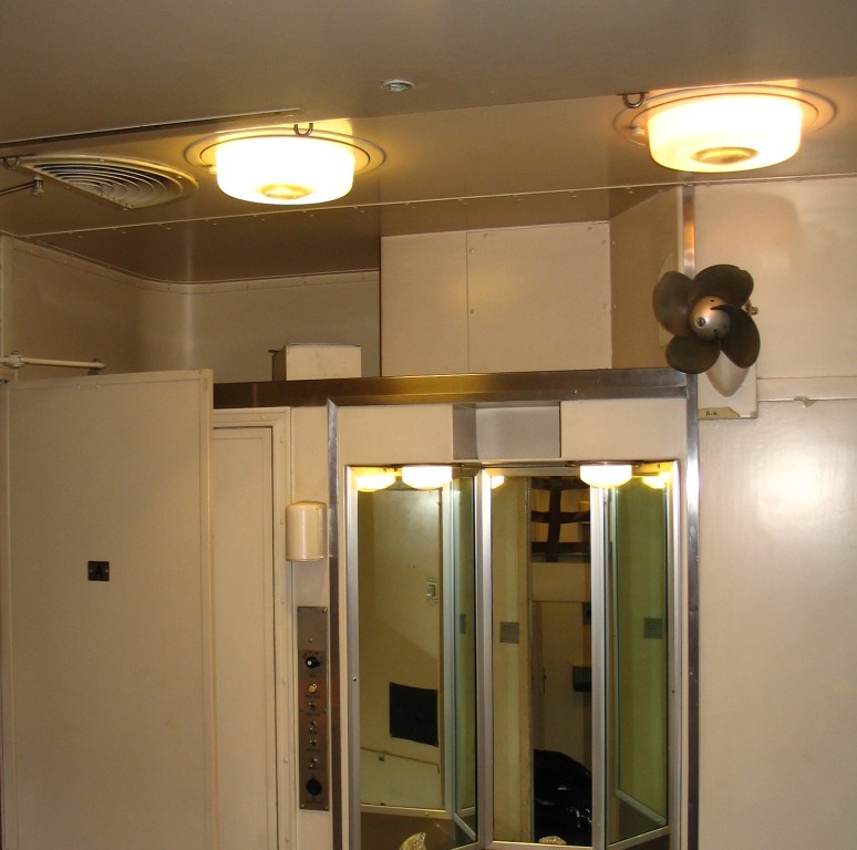

The roomettes and bedrooms of our Plan 4167a sleeper 'City of Lima' are equipped with Westinghouse air circulation fans with flexible rubber blades. These rubber blades are based on the Samson Safe Flex fans which were popular in the '30's and '40's (I recall some were still in phone booths in the 1960's).
Needless to say, many of these have deteriorated, and we've been looking at reproducing the blade inserts. Thanks to the work of one of our members, we have found a source in the fan restoration field that can reproduce the blades.
As usual, the price gets better the more we have made. If any of you have a need for replacement blades on your circulation fans, please drop me a line at jisaksen (at) eldcps.org.

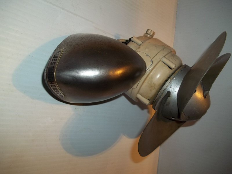

I'm new here. Did anyone ever succeed in this venture of reproducing the Westinghouse rubber wings? I collect old Westinghouse fans and was fortunate to get my hands on a few complete fans.
Thanks Tony

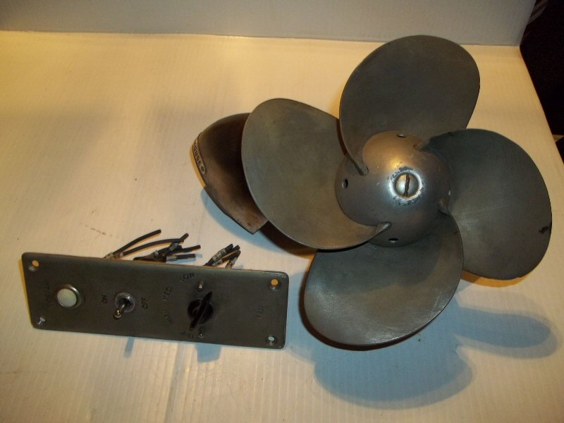

With panel.
