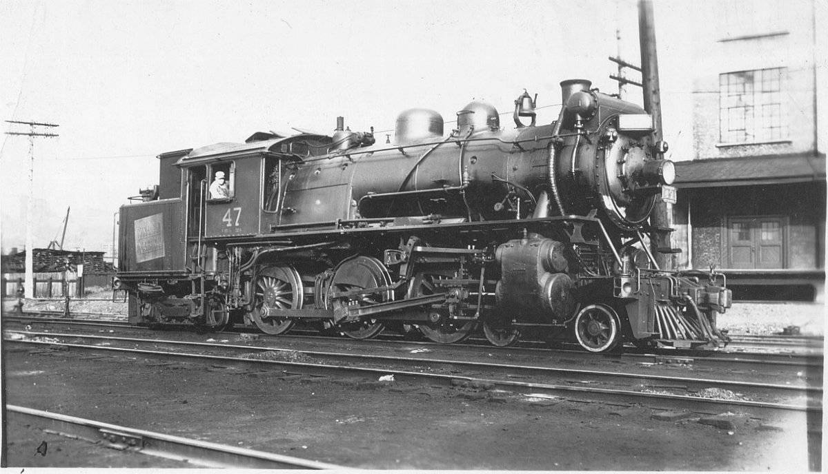

New thread, as these are NOT Hudsons.
These little commuter locomotives were constructed for bi-directional service out of Montreal. #46 remains at Valle Junction, Quebec, and appears to be in pretty good condition. Most parts were in place when I last examined it. A representative of the group which owns it, told me they might consider selling it to get money for other projects.
#47, outdoors and neglected at Steamtown, seems the ideal locomotive for their operation. Nelson Blount loved her until the revelation of lack of boiler information came to light. Her papers were destroyed in a fire, years before. Solution, at least my first thought is to drag her indoors, tear her down, examine everything, document it, and return the locomotive to service with a clean slate.
#49, part of the national Canadian collection. She's indoors, dry, and painted. Maybe some day???

Canadian National 47
(ex-Grand Trunk Railway 1542)
Power type Steam
Builder Montreal Locomotive Works
Order number Q-241
Serial number 54896
Build date September 1914
Configuration 4-6-4T
UIC classification 2′C2′ h2t
Gauge 4 ft 8 1⁄2 in (1,435 mm)
Leading wheel
diameter 31.25 in (0.794 m)
Driver diameter 63 in (1.600 m)
Trailing wheel
Minimum curve 16°
Wheelbase 39 ft 4.5 in (12.00 m)
Length 50 ft 2.25 in (15.30 m)
Weight on drivers 146,000 lb (66.2 t)
Locomotive weight 275,000 lb (124.7 t)
Fuel type Coal
Fuel capacity 5 long tons (5.1 t)
Water capacity 2,900 imperial gallons (13,000 l; 3,500 US gal)
Boiler pressure 210 lbf/in² (1.45 MPa)
Firegrate area 47 sq ft (4.4 m2)
Heating surface:
Tubes and flues 1,628 sq ft (151.2 m2)
Heating surface:
Firebox 160 sq ft (15 m2)
Superheater type Schmidt
Superheater area 342 sq ft (31.8 m2)
Cylinders Two, outside
Cylinder size 21 in × 26 in (533 mm × 660 mm)
Valve gear Walschaerts
Valve type 11-inch (279 mm) piston valves
Tractive effort 32,487 lbf (144.51 kN)
Train heating Steam heat
Train brakes Air
Career GTR » CN
Class GTR: K2
CN: X-10-a
Power class CN: 32%
Number in class 2 of 6
Number GT: 1542
CN: 47
