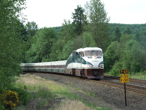

In the photo of the curve, the sign says "T-30, P-30". "P" is for passenger. What is "T"?
The T is for Talgo in this case, P being for other types of Passenger car.
They are obviously both the same limit at this point, but can vary elsewhere on the route.
I took this photo at Vader, WA, in June this year which shows the different speeds for Talgo (65), Passenger (55) & Freight (50)......
