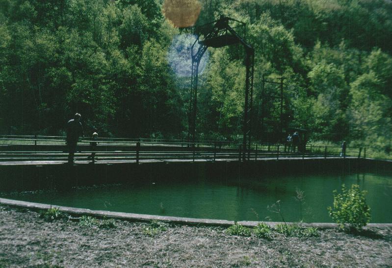

The old turntable at Jim Thorpe PA (ex-CNJ I think) illustrates the problems of a turntable in a high-water table area back in 1991.

 Post subject: Re: Info about Bridge-Style Turntables
PostPosted: Thu Nov 30, 2017 8:43 pm
Posts: 1182
Not so much high water table as blocked pit drain pipes, I think. The yard at Jim Thorpe is several feet above the high-water level of the Lehigh River, about 600 feet away.
