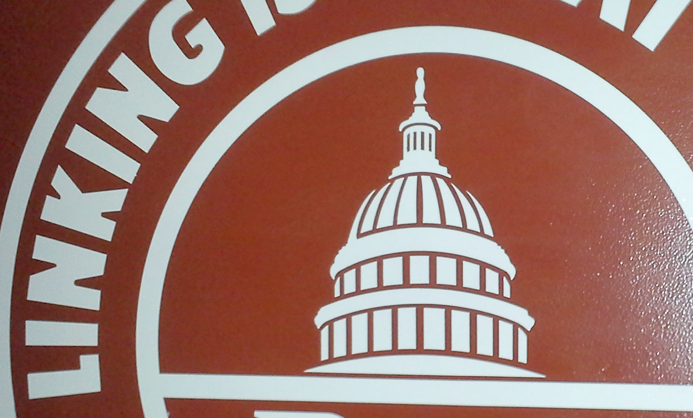

Looks great so far. Curious question - will/did you spray or brush the white? While brushing would likely be more authentic, given the not-so-pristine surface of an old car, I'd think spraying would give a better result with less bleed under the stencil.
 Post subject: Re: IRM Wagontop Restoration
PostPosted: Mon Oct 23, 2017 8:12 pm
Posts: 344
Going for the 1955 rebuild look I assumed a stencil of some kind was used. We used low stick vinyl masking cut to our graphics. Then used a small foam roller to put on primer and two coats of white gloss enamel.
As the car is pitted from rust we had some trouble getting the vinyl or painters tape to stick when it turned colder (below 60F).
PostPosted: Mon Oct 23, 2017 10:49 pm
One trick, if you can stand the wait for another drying cycle, is to paint a coat of the background color, in this case the car color, as the first coat in the stencil. The result is that coat seals the stencil, and any bleed under matches the background, yielding a sharp image.
That technique works well with some paints and I'd recommend a test first as it can be tricky. With a full cure after sealing the edges, you might have a heck of a time removing the stencil (been there). If your paint develops a dry film before it's cured and you're able to put another coat over top without bleed-through, the stencil should come off much easier but be careful not to lift the edge of the semi-cured base coat with it (been there, too). This is much easier with automotive paints that aren't a high build but still not as easy as with model paints. Your mileage may vary.
My preference would be to spray and touch-up by hand if necessary.

Pulled the stencils from one side and took another poor picture with my phone. We are happy with the results. Only the most pitted areas had some paint creep under the vinyl.
Have to wait for the car to be moved to it's indoor parking space to get a good outdoor photo.

I'd say that came out pretty darn good. I don't think you could have asked for better.
