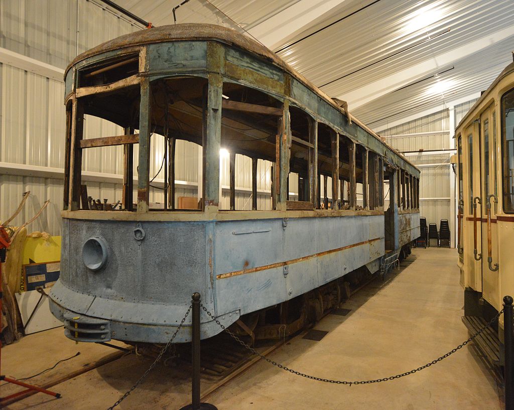

Has any museum put a non-restored artifact front and center for the public? (That's a serious question.) But the model we seem to want to follow is to create a nice-look car and pretend it's the real thing.
National Capital Trolley Museum displays two non-restored cars in Streetcar Hall.
Washington Railway & Electric Company 650 (Brill, 1912)
Capital Transit 1430 (St. Louis Car Co. 1944)
There are plans to restore both cars to service, but not "soon."
Prior to the fire, we had planned to permanently display DC Transit 0509 in as-is condition with no plans to alter its condition. The car had been heavily modified in its 104-year life. After 25 years of regular use as our work car, DCTS 0509 was ready for retirement as a display artifact.
