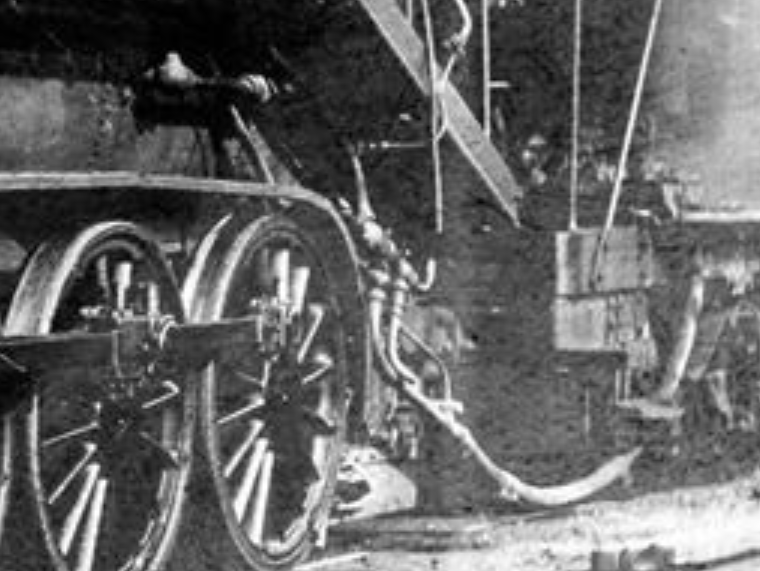

If I recall correctly, the position of the injectors indicate they were non-lifting. The piping shows they were mounted on the side of the firebox, just behind the rear driver set. The locomotive arrived at the NMOT (Yes, the name has recently been changed back to National Museum of Transport) without injectors- photos confirm this.

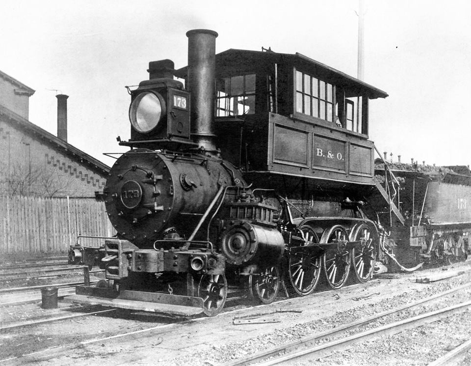

I found this photo of 173 online, the injector is there but it is hard to make out any detail-can any of you experts out there identify it? It was taken sometime post-1884, but likely before the upgrades were made in the 1890's.
(Photo Credit to Steven Allen at https://www.pinterest.co.uk/pin/314266880225451206/)
The age and number of changes this locomotive went through is making this restoration an interesting one for us in the NMOT shop. Your help is much appreciated.

PostPosted: Mon Oct 16, 2017 6:49 pm
Can you imagine this running in 189x, and for such a major railroad?
Were they just cheap, or what?
 Post subject: Re: Need help with B&O injectors
PostPosted: Mon Oct 16, 2017 7:41 pm
Posts: 2733
I still think they are lifting injectors in a non-lifting role. The Chinese were known to do this.
