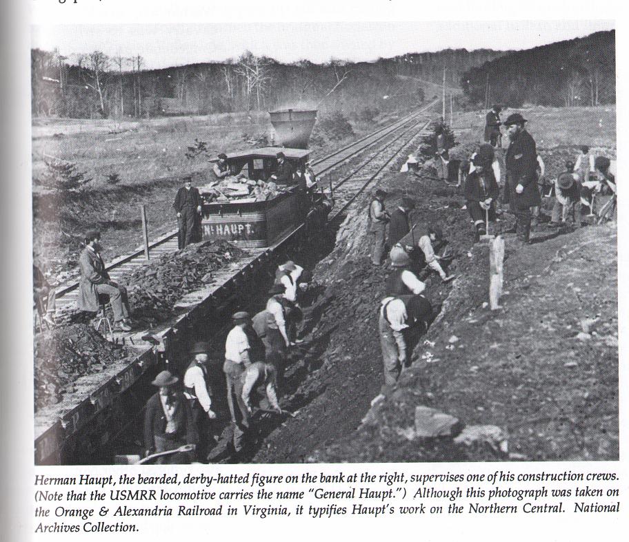

The was a discussion I saw somewhere about how these items were transported before gondolas were "invented". Basically it was from the beginning in 1828-about 1854.
I found this photo from the civil war in "The Story of the Northern Central Railway" by Gunnarsson on page 63. Although taken during the Civil War, it demonstrates how flats were loaded with loose commodities.
FWIW
Doug vV
 Post subject: Re: Transporting dirt, coal, gravel, etc prior to gons
PostPosted: Fri Oct 06, 2017 8:11 am
The photo is misleading, in that they aren't "transporting" the material in common carriage. They likely won't take it any further than the embankment visible just ahead of the locomotive, where they will shovel it off again to widen the fill. The flatcars have stake pockets, so at least temporary side boards to convert them into gondolas are a possibility. Why they aren't using them is it is hard to shovel from the ground over the sides of a gon, and then the gon takes longer to unload. For a short distance, they get better labor utilization by just shuttling back and forth with flatcars.

Although I can't prove it, I expect that flat cars with sides built up from stake pockets have been around a very long time. Gondolas are an easy next step.
The Southern Pacific Narrow Gauge book by Robert Bader lists flat cars and gondolas in the same roster; most likely they were interchangeable.
The WW&F Railway Museum is building their right of way with two flat cars using temporary side boards held to stake pockets. They have moved heaps of gravel and ballast this way.
Ted Miles, WW&F Member

Somewhere I read that flatcars were the preferred way to haul dirt when constructing the panama canal. The sticky clay soil would stick in the dump cars making them hard to unload. But they could pile the dirt on the flats and then just push it off with less trouble and quicker. I have seen photos of both methods in use.

General Haupt was the man in charge of the U.S. Army railroad (reconstruction and operation) activity during the Civil War.
