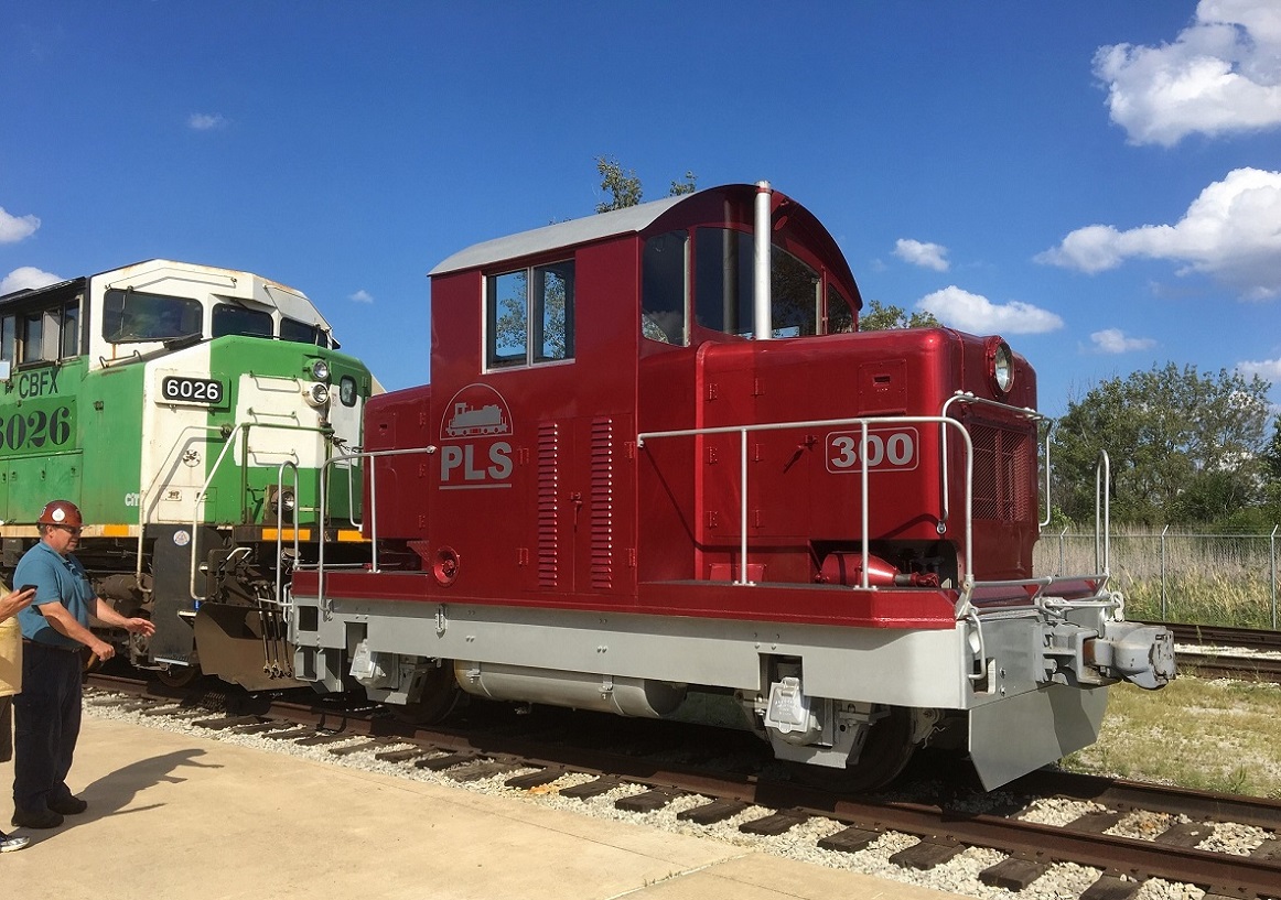

I had a nice visit yesterday with (and how many people can say this?) an EMD Model 40 at Professional Locomotive Services in East Chicago, IN. Thank you to the staff at PLS for letting us see this survivor that they have restored to museum quality! Note the wood trim in the cab and there are roller bearings behind those friction bearing covers! Order number E574-1 was built in 8-22-1942 with serial number 2284 for the US Army # 7952, it was sold to Acme Newport Steel (Newport, KY) NPTX #1, Professional Loco services rescued this unit that was very close to being scrapped. The unit was trucked to East Chicago and thoroughly rebuilt by PLS to better than new condition. The "critter" now serves as PLS shop switcher, resplendent in Ferrari Red and moving much larger units like SD60M's or AC4400's with ease! Some time back I thought that I read that the builder's plate was being held by someone until the unit was finished and that they wanted to give the plate back. If anyone knows about this, PLS would love to get the plate mounted back on the 300...if you look at my pictures, you can see the six mounting holes in the frame below the cab!
 Post subject: Re: EMD Model 40's
PostPosted: Fri Sep 07, 2018 12:08 am
The GM Detroit 71-series was developed in the late 1930's and is similar in operation to the EMC 567 series: 2-stroke uniflow engines with admission thru ports at the bottom of the cylinder and exhaust through poppet valves at the top. The Roots blower supplies air which has to be enough above atmospheric to push the exhaust out the top. Until 1957 they were inline only and the 6 cylinder 671 was the biggest engine in the series. To get more power GM paired 671's and geared them together which is what's in the Model 40. Australia's Victorian Railways EMC gas-electric motor cars were reengined with paired 671's as well.
PostPosted: Fri Sep 07, 2018 10:47 am
Posts: 6482
Here's one of John's photos from his visit to PLS.
PLS 300 East Chicago, IN 9-5-2018 Photo by John Eagan.jpg [ 349.72 KiB | Viewed 17629 times ]
