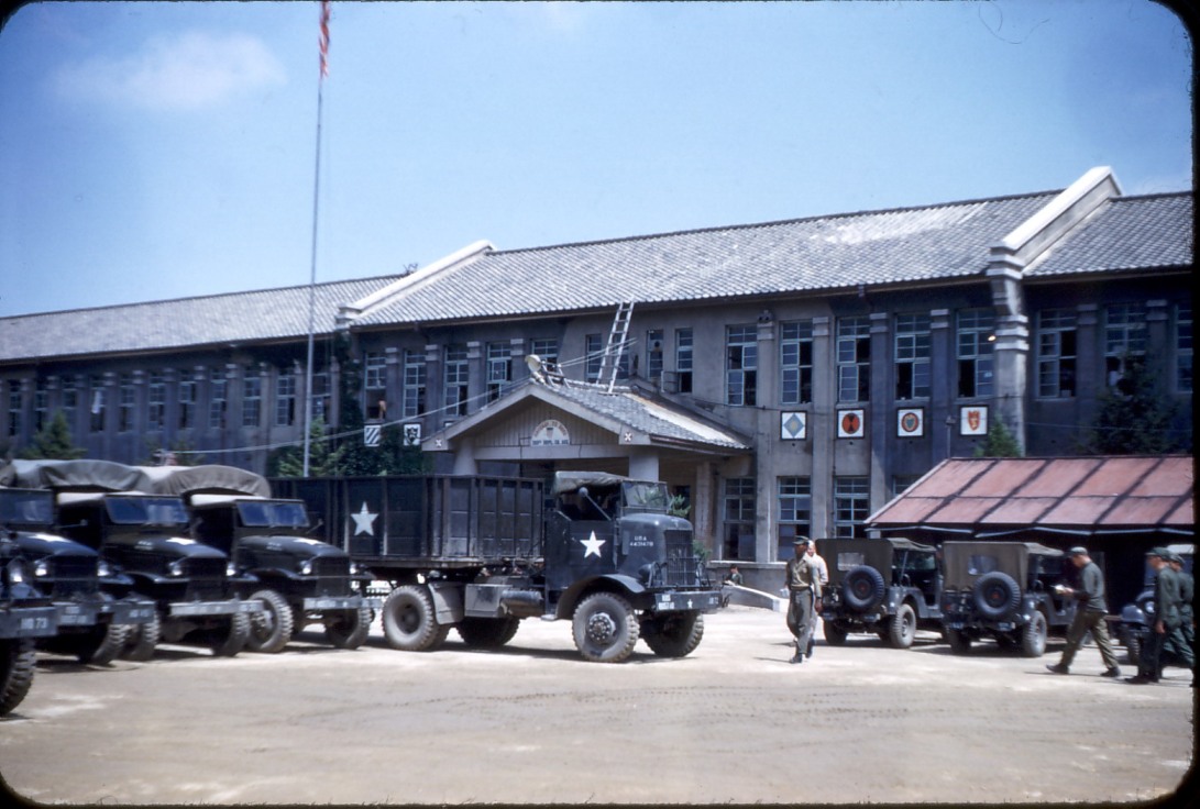

Joined: Tue Mar 10, 2015 10:29 am
Posts: 86
Location: Michigan
The second paint test does look better. Looks good!
This thread is particularly interesting to me because it’s discussing a piece of railroad equipment
constructed for use by the military. I don’t know if the rail car in the conversation is of WWII era,
or Korea. (It may help to fill in that blank for those reading the topic.)
One would guess the “green” color from both conflicts would be the same.
Would not a piece of equipment constructed for use by the military have to adhere to a military specification
and not the whim of the manufacturer?
[CREEPING DEATH] replied to this thread back on September, 28th:
“I don't recall the source off hand, but I recall reading once that 'Pullman Green' was the exact same as 'Olive Drab' as used during WWII.”
I would agree with CD’s comment above.
The attached photos were taken in 1953 near the end of the Korean War. A couple of the vehicles
positioned between the faded trucks with trailers appear to have a very similar color to the second painting test of the rail car.
(Granted, a color slide taken 64 years ago is open to discrepancies.)
Military paint specifications must exist somewhere and those too, could be a potential source for what color
the car may have actually been painted when it was first delivered to the customer.
John

 Post subject: Re: Pullman troop sleeper color test
PostPosted: Wed Oct 25, 2017 8:40 am
John
Hardly the whim of the manufacturer. These cars are WWII era, and were built for the Pullman Co. I'm sure Pullman would really rather have had real passenger cars, but because of the national emergency, the War Production Board would not authorize the use of that much material, so a modified freightcar design was used. The cars were operated by Pullman, not the military, and Pullman attempted to maintain their usual standards of service. However, because the comfort level was not in keeping with their regular fleet, Pullman never used these cars in their civilian trains.
