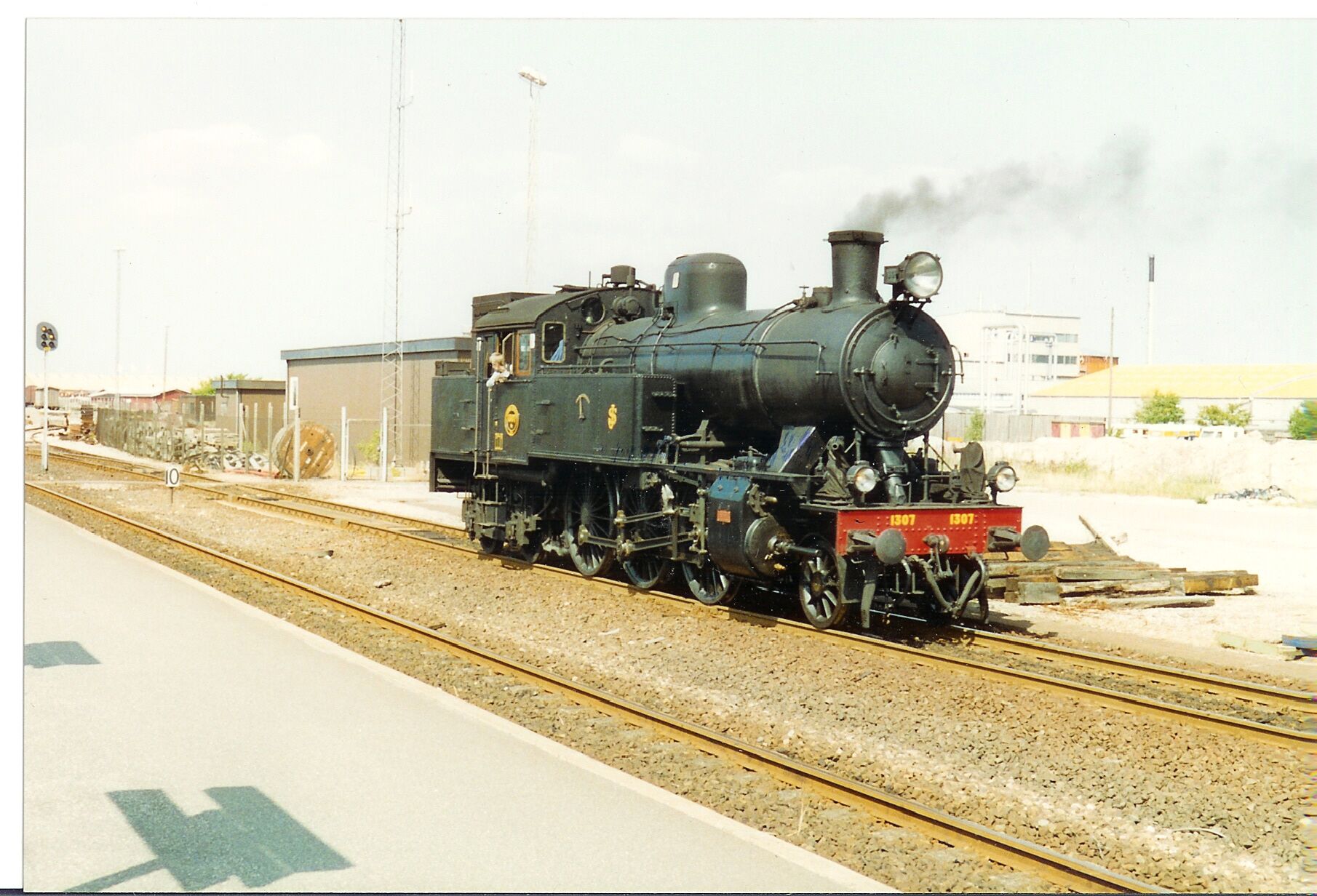

Does anyone out there have drawings for any kind of vintage (1960's and under) Reflex Water Gauge body and lid? The head of the steam department (and my boss) wants to manufacture two new Reflex Water Gauges out of bronze to replace tube glass gauges that are currently fitted to the current locomotive in the shop (see below).
He is an engineer by career who has worked with pressure vessels and will safely make any modifications necessary to accommodate for material differences.
The locomotive has been through three different versions of water gauges; Swedish (original), German, and now Danish, so yet another change is not really an issue. He wants to create something that looks similar to these:
https://www.heritagesteamsupplies.co.uk ... auges.html
but without the associated cost of these units.
Any help is greatly appreciated!
