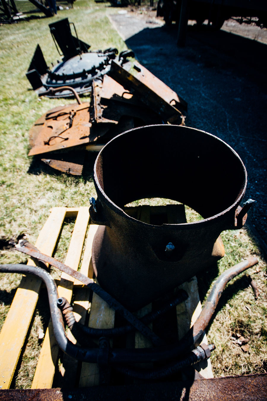

Were items like the headlight and Mars light removed and saved somewhere ?
I stumbled upon these flickr photos from the Northwest Indiana Railway Preservation Society of the 624's restored Mars light and number boards. I was wondering if these items will convey with the locomotive?
https://www.flickr.com/photos/nwirps/50 ... 168362929/
Best,
-Andrew

When it comes to jewelry, we have possession of everything except the whistle, marker lights and builders plates (cab gauges were removed in the 1950s-60s for steam restoration and operation efforts elsewhere in the Chicago region.) The whistle apparently was removed in the early 1990s and we're following up with rumors/reports of where it went and who removed it, but so far have turned up nothing. Our agreement with the City of Hammond also requires copies of all documentation related to 624 and components like the bell, which is on display across the street.
There's a surprising story about the headlight, Mars Light and numberboard's I'll relay to members in our next newsletter, due for print in April.
You can become a member or renew your membership here: http://fortwaynerailroad.org/renew/
Our newsletters have been described as some of the best in the industry and you can download the latest edition at the link above as a preview of what members receive.

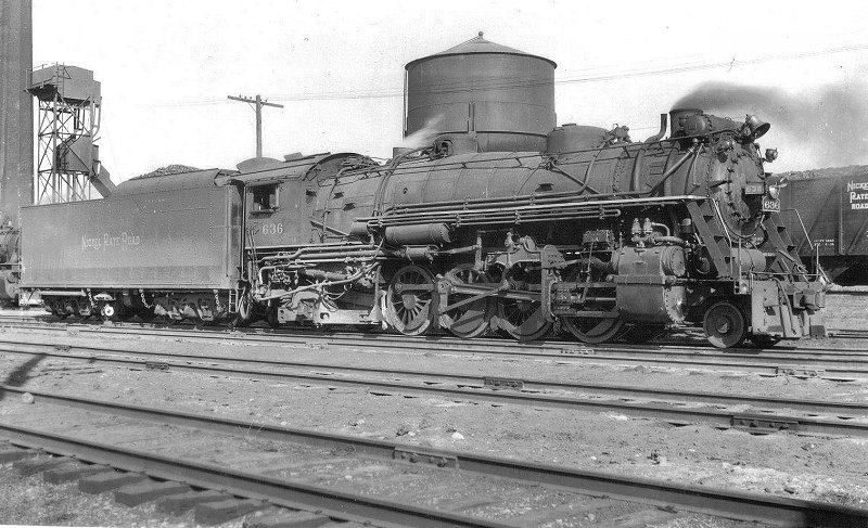

From the city's first release photo - is 624's cylinder block cracked on engineer's side? Serviceable for restoration?
G.

I think what you may be seeing is the jacketing around the casting.
There appears to be some damage from when the engine was moved so the other display equipment could be inserted behind it, but nothing sinister.

The H-6 class was prone to cylinder cracking, and outside bracing was applied to forestall it. The bracing is visible on photos of the 624, and also appears here in this photo (Gary Thompson collection) of the ill-fated 636 which was wrecked twice (1942 and 1943),

Thanks rl - the brace was what I was referring to.
Kelly - I questioned it because I didn't see one on the left side, at least not in any pictures that have been posted/linked here. Would be interesting if the cylinder halves were so different that they were prone to failure on just one side. They aren't three cylinder engines are they?

Indeed, the braces are aftermarket mods - likely removed from 624 when they did the abatement in the 70s.
We understand the NKP did this more as a preliminarily measure once they noticed failures (rather quickly in the late 20s) and less as a bandaid. 587 had them at one point as well.
2 cylinder only.
