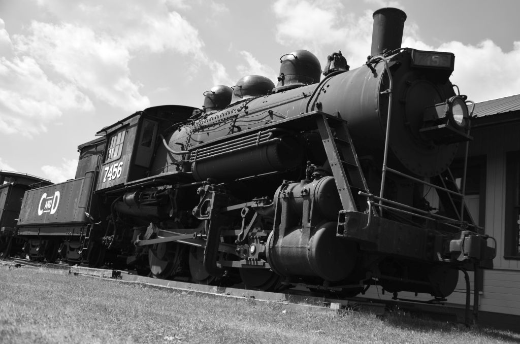

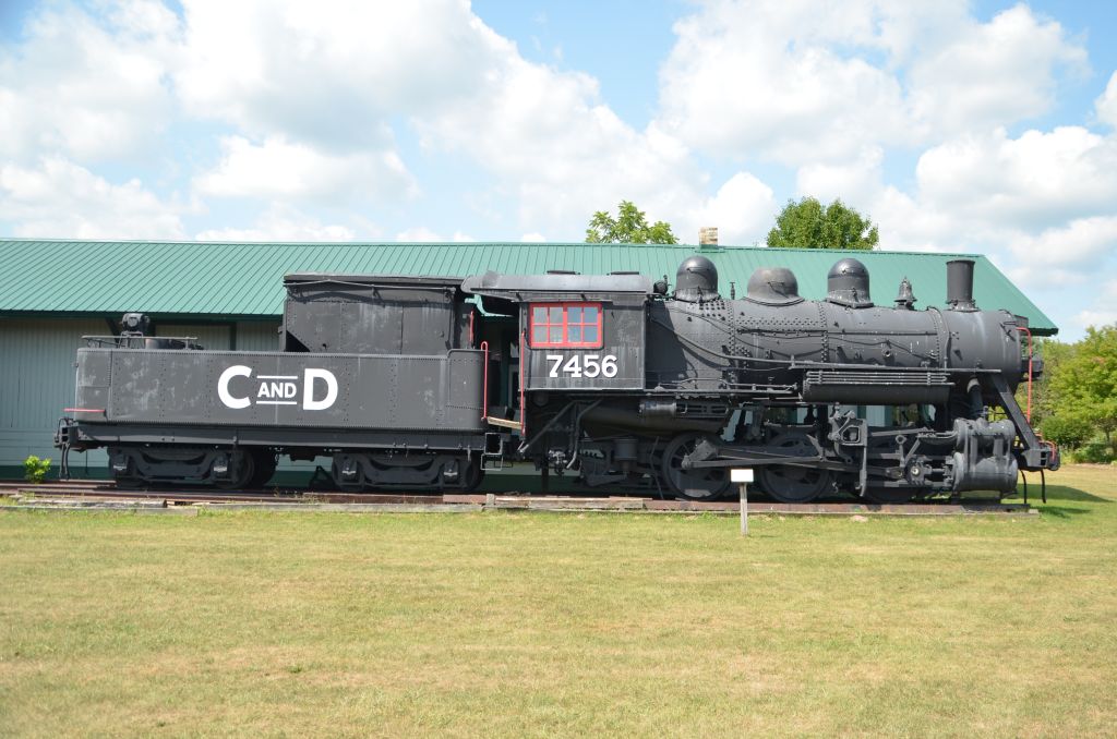

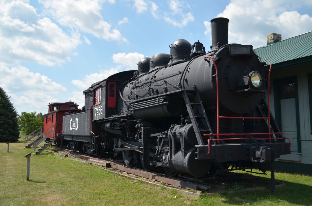

Took a trip from Port Huron to Muskegon on Wednesday, and made a side trip to check out this engine. Many of her sisters ran in the Niagara Region, so wanted to see her up close. I admit that I was surprised to see her with the C&D lettering. Have you figured out how you're going to get the rods and everything back in place? A front end loader might help the cause. Might have enough power to move it that little bit.

Why move the entire locomotive when you can just move the piston and crosshead assembly? Might need to fake the wrist pin with something you can install from the front, but good enough for a static display.

Guess it depends on how much you want to get hooked back up. Moving the piston would be fine, providing it's not seized. Either way, always good to see rods back in place.

The appearance of this locomotive would be greatly improved if that H shaped handrail was removed (which isn't in the in service photo on the first page), a new piece of sheet metal fitted over the cylinder and foot boards applied.

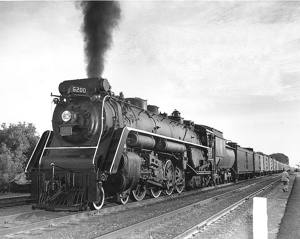

In my experience, CN LOVED messing with the handrails on the fronts of its steam locomotives. CNR 6167 for example went through at least 3 different arrangements (that I know of). I'd bet it came off of CN like that. Of course, looking through my archives, none of the photos I have of the other engines in that class (O-18-a) seem to have received that arrangement...
Perhaps 7456 got into a wreck somewhere along the line? I wonder if there are still traces of where the handrail stanchions from the original configuration once were on the smokebox front.
Maybe one of the reasons for that design of handrail was to facilitate accessing the headlight. I know on 6167 we have to stand on that handrail to get at the light.
What would make it look better is if they weren't painted red! (Should be black) (unless it was in passenger service, then only the front handrails would be painted white, the rest along the boiler would be black)
Kind of like the 6200 here:

The front foot boards are there, plan to install them but then it makes access to climbers much easier....Maybe not a good idea?
robteed -
I think putting the foot boards back on would improve the engines looks. Maybe "KEEP OFF" lettering on each. I think the "H shaped" hand rail doesn't look that bad, and Joe's idea to paint it black will improve it. It's hard to tell, but in the first photo of the 7456 working for C and D but when it was still lettered (and maybe leased) from CN, it looks as if that "H shaped" hand rail might have been on the engine at that time.
