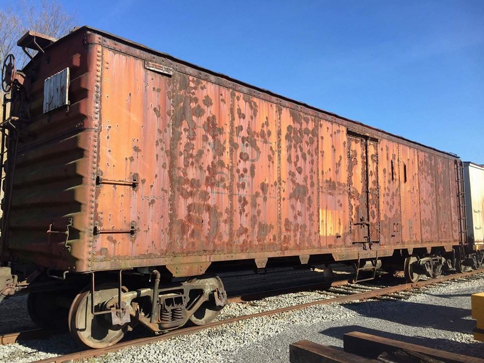

Last year, we attempted to give three freight cars a quick facelift to make them presentable for public display at the Rochester & Genesee Valley Railroad Museum. One of the cars I worked on was MDT 12549 (Despatch Shops, 1953). This car arrived on the property in 1997, and has been in storage since then. Last year, we scraped the east side and applied a coat of Rustoleum Rusty Metal Primer. Unfortunately, we didn't get farther than that and had to move on to other projects. But it was better than nothing.
http://rgvrrm.org/about/railroad/mdt12549/

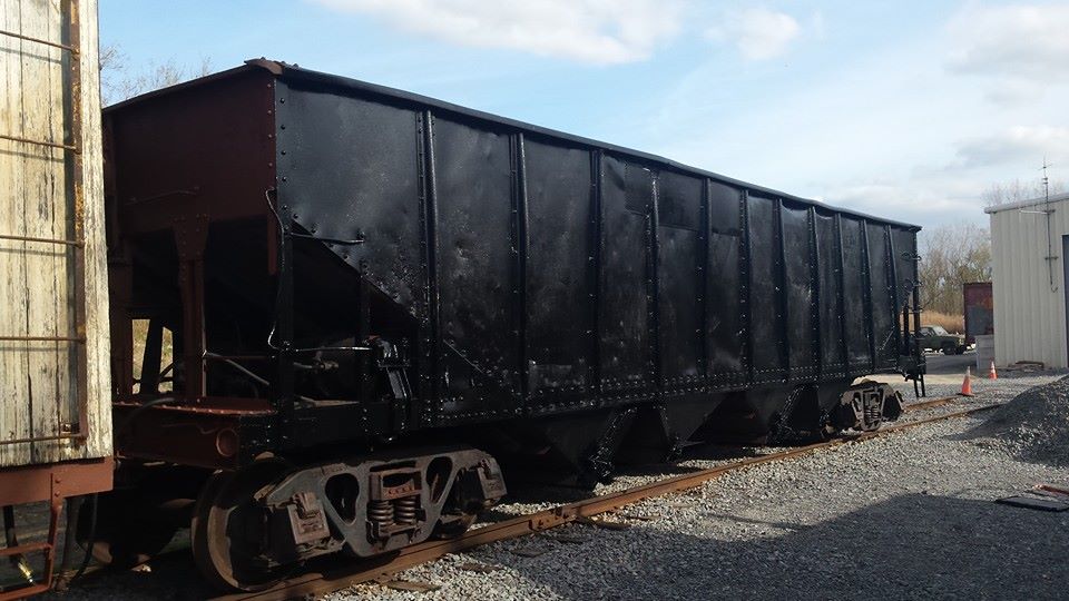

This year I decided we needed to finish the job, especially since visitors could see the still rusty west side as the train ride passed by. We moved four of our freight car displays off Track 6 (Which has a steep drop-off on the west side) to an adjacent track so we could work on both sides of the cars easily. Some work had started on the PRR hopper car, so we decided we would finish the job on that car, too.
http://rgvrrm.org/about/railroad/prr747803
Just a note that these are not restorations. This is stabilization and clean up. We may apply some lettering to these cars, but the goal is to get a fresh coat of paint on first. Any existing lettering was photographed for reference before the cars were covered over.
We had the freight cars moved to Track 9 on April 16.
File comment: MDT 12549 - April 16, 2016
File comment: PRR 747803 - April 16, 2016

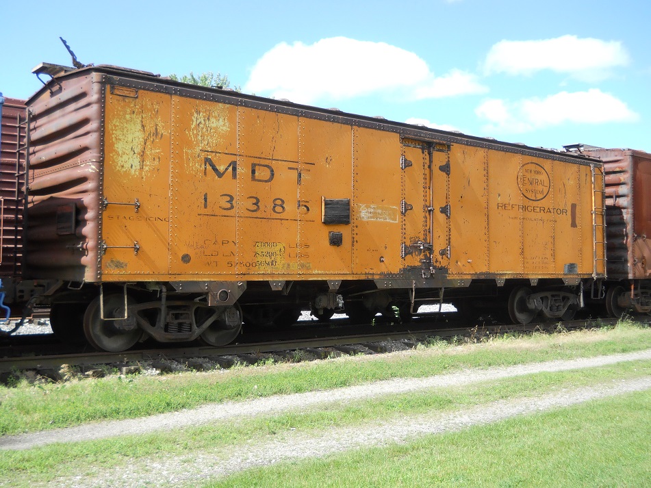

 Post subject: Re: Painting steel freight cars at R&GVRRM
PostPosted: Thu May 05, 2016 6:38 pm
Joined: Tue Jun 02, 2015 10:57 pm
Posts: 36
Otto - if MDT 13385 above is the right color, you might be better off using yellow with a little bit of chocolate brown in it. In any case, to match the color, this is what I would do (since I was a color matcher in the printing industry for a while).
1. Buy a glass measuring cup with a handle.
2. Open a can of your yellow paint, and paint a little on the car so you have a starting point.
3. Pour that gallon of yellow into a bigger pail. Then get a quarter of a cup of chocolate brown, pour it into the yellow and mix it up. Then paint a little on the car next to your yellow patch and see what it looks like. (Starting with a very small amount of the darker color is recommended, because if you overshoot, you can't take it out again).
3. If the yellow is still too bright, slowly add more brown and record how much you add. Paint another small patch on the car each time.
4. If the color looks like it needs red, add it in small amounts, record how much you add, and paint a small patch each time.
This will not only give you your desired color, but also a formula which you can use to mix it again. However, I would mix enough at one time to do the whole car, because minor variations in mixing several batches could yield slightly different colors.

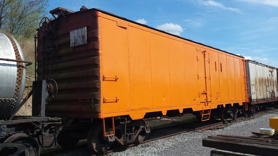

Nah, four years of art school to be a graphic designer, I gotta do something with the degree. I just mixed a new batch using two gallons yellow, one qt. red, one qt. yellow and got a color much closer to what I wanted. Behold:
File comment: Revised orange from May 7, 2016
I had just enough paint to do both sides. The ends are in pretty good shape, so we won't touch them for now.

Tom Davidson wrote:
Is that PRR H21 the one that was at Karthaus?
PRR 747803 was used for glass storage at the Owens-Illinois plant in Brockport, N.Y., for many years.

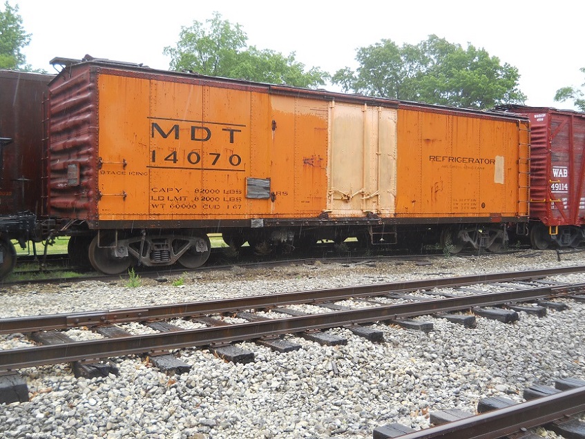

PostPosted: Tue Jun 07, 2016 2:26 pm
Les Beckman wrote:
Otto -
Thanks for posting the photo of MDT #14053. Our number 14070 is similar in appearance and also, sadly, without a railroad herald.
Before we get off of this subject completely, I thought I'd include a photo of our MDT 14070. This car was "cleaned" quite a few years ago and the MDT paint has held up very well. One thing we did not do however, was a good job of matching the paint on the very badly pitted door. From the hints given in this thread, I'm going to try again!
