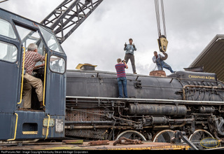

Hi
Looks like work has begun on C&O # 2716 , I pulled this off yahoo groups .
vRemarks & Notes
The Kentucky Steam Heritage Corp. members work with Kentucky Railway Museum's Mark Johnson, operating the crane, on removing the steam dome cap of 2716 in preparation of a evaluation of her current condition to determine her viability, and get a cost estimate on a operational restoration. The full weekend of inspection revealed 2716 to be in excellent overall condition and a worthy candidate for a full restoration. Today 2-7-16 the full campaign was unveiled to the public. If you would like more information on the project, would like to volunteer, donate, or help in any way visit http://www.2716.org to get on board with giving 2716 a

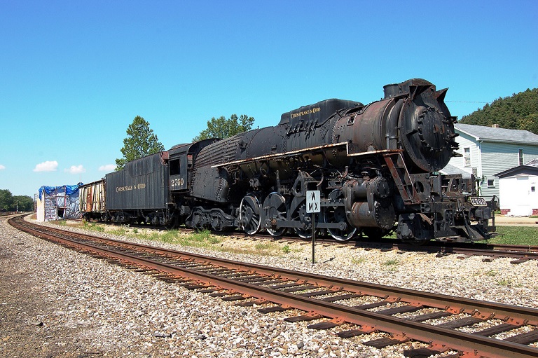

and poor 2700
