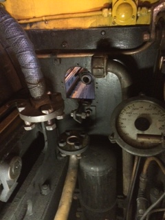

As part of winter overhaul we pulled the injectors off of DSB K582. This was three hours of work for two guys. These injectors are in impossible to access locations with no room to swing a wrench. And for some annoying reason, they use coupling nuts on the supply and overflow lines, but they use bolted flanges on the steam and suction lines. Engineer's injector is right up against screw reverse, and one bad move with the wrench and you smash the speedometer. And all the nuts are gummed up and tight requiring wrench removal all the way.
Why couldn't they use coupling nuts all the way around?
p.s. and somebody assembled them with three different bolt head sizes
File comment: Where they came from
File comment: Injectors on the workbench
