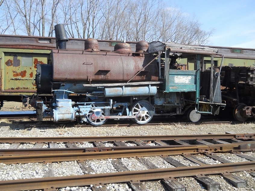

Well, since Sammy has let the cat out of the bag, here's a photo of the old girl which was taken at HVRM about a month ago. Obviously, he has a lot of work ahead of him. But as they say, Hope Springs Eternal! And if anyone can bring her back to life, Sammy can!

You gentlemen flatter a grouchy old man !!! Thanks to you all so very kindly, of course my concern is that I will not be able to live up to the nice things you fellas just said.
The saddletanker of my dreams sure can, though, thanks for posting her pretty little picture, Les. Thanks for painting over the Thomas face, too.

Gee Sammy, a little black paint and some wood filler and she should be ready to go.
Has it been ultra sound tested and are you going for a full FRA rehab?

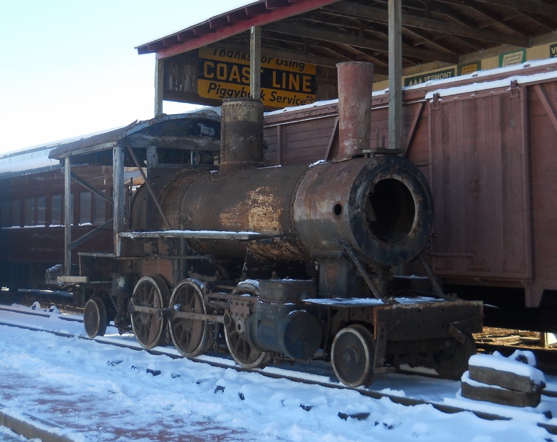

Congratulations on the new acquisition! This seems to be the year for Coronet Phosphate engines. #5, a 2-6-2T Porter was moved to the Colfax Railroad Museum in December. We do have a Porter parts book, if you need help. If you can get a cab photo, it would help us in identifying what's missing on our loco. By the way, the smoke box is now back on the engine. It was in six pieces that we found scattered around its former location. We had them rewelded and work is now proceeding on the cab.

No, she hasn't been ultrasounded yet. I HAVEN'T EVEN LOOKED IN HER SMOKEBOX !!! In every picture I've seen, the stack was covered, don't try and make me all nervous now.... I'd like to get her FRA legal someday, but I'm thinking of patching her up, making her look decent, and getting a state certificate to begin with, so we can play with her before we pull the tubes. I'll know more once she's parked five minutes from my house, and all my steam experienced friends can get a good look at her. Then, I gotta figure out what's broke, what's missing, and what it's all going to cost to fix, before planning the job. Don't expect miracles --- this would be easy for a real railroad, but we're a bunch of underfunded old retirees on 60' of track in a vacant lot. Even though I have the best help imaginable, and close at hand, progress will be slow, and success is not assured
Regardless of price, condition, or location, this is 2015, and there are only about a dozen Porter 0-4-2T locomotives in the whole world. This was the only one available, and, honestly, who could resist a face like that ???

Dave, the truth is that I willingly bought 42 tons of trouble. I'm a big boy, I can take it. However, I'm pretty sure that my back truck baby has been reboilered, if you look close you can tell that the boiler doesn't quite fit, but that they made it fit anyway. In the few short minutes I spent inspecting her the other day, I stuck my fingers as far into one of the mud ring washout plug openings as I could, and the metal felt smooth with no signs of flake rust, mud, or grooving of the sheets, and with only a little bit of normal scale present. So far so good.
