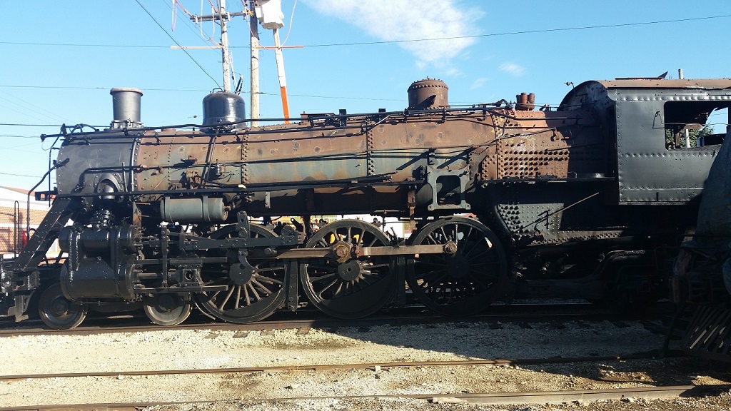

Summer work has, once again, wrapped up on Rock Island 4-6-2 #938 at the Illinois Railway Museum. The front of the engine was the focus this year, and work there took much more time than had been planned. But we were rewarded with a pretty significant improvement in the old Pacific's appearance.
If you look closely you can see where the volunteer managing the project, Phil, took some UT readings at various spots on the boiler. Many of the readings on the shell were around the 3/4 in mark, which isn't bad considering! But the numbers on the firebox were far worse. IF we would ever consider returning her to steam, she would need significant firebox work.

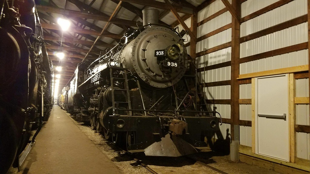

I'm going to bring this thread back from oblivion instead of creating a new one. The IRM Steam Team has just about completed cosmetic work on Rock Island 4-6-2 #938. Aside from the cab and tender lettering/heralds, work has completed. A lot of hands have helped with this project over the years; I can't give them all a shout out, but thanks are definitely in order!
This project started as a "save what's left" endeavor, and became something more as the tubes were removed and the condition of the engine was documented in some detail. I'll summarize those findings here, briefly. The boiler is okay, but the wrapper sheet is thin and there are other spots that would need work. The smokebox needs work, as the lower 1/3 - 1/2 is pretty thin. The cab floor is shot, but the actual cab itself might be salvageable. Running gear is, from what I understand, tired. Valves need work, but are serviceable. The tender would likely need to be replaced, including the tree trunk currently serving as the rear truck spring (we have the correct spring somewhere). The trucks and frame might be good, but the rest of the tender is shot. The backhead is bare, and the appliances need work.
The angles in the shop don't allow for great pictures, so this will have to do. And, as I'm currently marooned at home recovering from hip surgery, I'm not planning on getting down to the museum for a while to get pics of my own. Picture credit - Don Panek.
The plan is to keep 938 indoors now that she's painted and looking better. So, if you would like to see her, Barn 9 will be the place to do so. Picture credit - Blake Bushue.
So, now that we know her general condition (summarized as fair-poor), I'll answer the question before it's asked. No, we are not considering 938 for operational restoration at this time. Now, if some Rock Island enthusiast donated anywhere between $800,000 or $1,000,000, that would change her status. But, given that she's a tired old lady, she'll likely remain as a static display.
