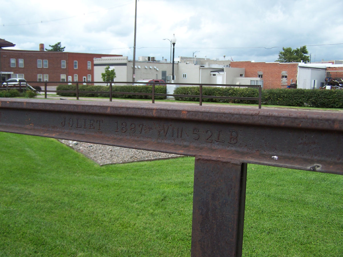

During our drive to Colorado Springs for the 2008 ARM conference, our group stopped off at Holdredge, Nebraska to visit the ex-CB&Q depot there. As shown in the general photo of the depot, the railing is made of old T-rail: Joliet 1887 52 lb. I took a close-up of the markings on the web of a section of the rail. This must have been put down when Native Americans were still about and the Burlington's standard power was 4-4-0s. While not being used as it was intended, this rail still serves the railroad in another capacity.
Holdredge is a stop for Amtrak's California Zephyr. There is also a caboose and a couple of pieces of track maintenance cars on display just to the east of the depot and at the time a heavyweight obs or PV to the west.

...As shown in the general photo of the depot, the railing is made of old T-rail: Joliet 1887 52 lb. I took a close-up of the markings on the web of a section of the rail. This must have been put down when Native Americans were still about and the Burlington's standard power was 4-4-0s. While not being used as it was intended, this rail still serves the railroad in another capacity.
I dare say that rail has fared better than the mill that rolled it:
Thanks!
Jim -
Thanks for posting the photo of the section of 52# rail made at Joliet in 1887. The "VIII" after the year probably means it was rolled in the 8th month, or August, of that year. This is the first I have seen of the Roman numerals used to indicate the month rolled. The rail sections I have seen would just have had 8 I's ("IIIIIIII") to indicate the eighth month. I wonder if this indication was peculiar to Joliet or if other producers once used the Roman system.
