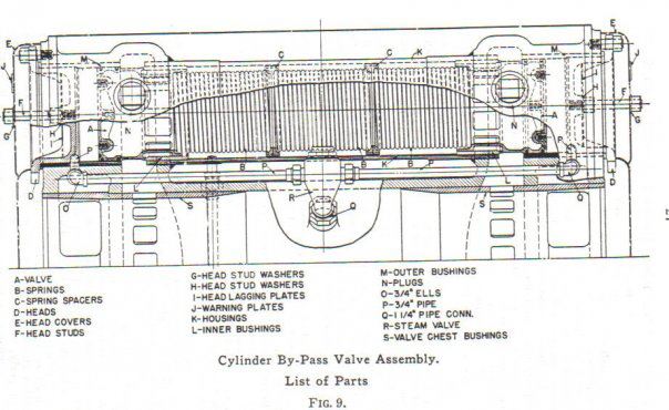

Just as an update: I have no idea what the proper attribution for this thing is, but it came off a link to 2926's Facebook page:
I would note that the original source for this calls it a 'Wagoner' valve; Porta (and by extension the ACE 3000 patent) probably are describing this with their reference to 'Wagoner' or 'Waggoner' throttles... do not be confused.

Hi Mike:
You are correct,: the Trofimov valves and their associated parts are mounted on the valve rod.
And Hugh is correct too: they are heavy. To support the weight, they have extra long valve rods which are supported by bushings in the front valve heads.
One of the main advantages of the Trofimov valve is that it can be retrofitted to any piston valve locomotive without replacing the cylinders. It is entirely internal. The Wagner drifitng valve as used by the AT&SF (and others) were part of the cylinder when it was cast, therefor could not be retrofitted except by renewing the cylinders.
I would note that when we disassembled our SY, we found that the bushings that guide the floating valve ends to their seated (operational) position were gummed up with carborized oil. However, the locomotive had run 98,000 miles without these being dis-assembled and serviced whereas in China this was done every 100,000 KM (about 62,000 miles), so it was a bit overdue...That said, once all the parts were cleaned up and measured, everything was within China Railway tolerances except for the rings (which we renewed).
