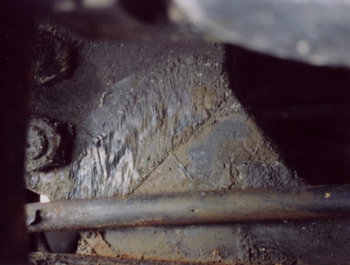

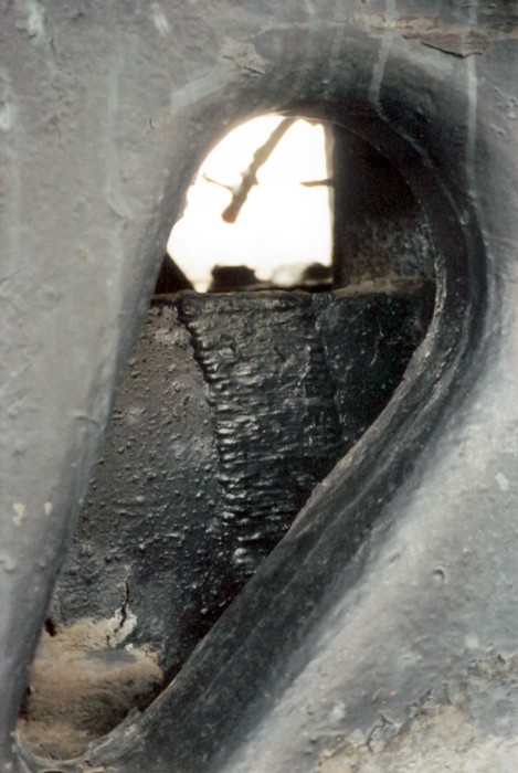

I've found some massive cracks and weld repairs on 6167's frame, and have done some reading on what is involved in repairing such cracks. Of course with a steam locomotive, once all the wheels are dropped, the frame becomes quite accessable for such work.
I have a copy of CNR's maintence Regulatio book which gives us an idea of what sorts of procedures and methods were employed during the 40's and 50's. There are clearly defined procedures for repairing frames, which included preheating the frame to about 500 degrees F for example, cutting away the fractured area with an oxy-acetlyne torch before filling the repair by electric welding.
Another regulation regarding axles and dated Dec 1954, called for ultrasonic testing, as well as magnetic particle testing. There is also mention of magnaflux testing new tires and wheels on a page dated August 1951. As well, a regulation concerning main and side rods dated April 1946 specifies that rods are to be magnaflux tested.
So this technology has been in use for quite some time.
File comment: Another massive weld repair, this is can be found at the front of the locomotive on the portion of the frame between the bumper and the cylinder saddle.
File comment: One of the more massive weld repairs to 6167's frame visible through one of the spokes of the driving wheels. This weld is maybe 4 inches wide and goes around the entire circumfrance of that portion of the frame.

The topic of GG1's comes up so often one might think maybe a group could be formed to conduct a careful evaluation of the condition of each survivor (as much as can be done without disassembly) with a goal of getting one to run. In addition to general condition, condition of the truck and main frames, some sort of preliminary electrical testing could be done on the 12 motors.
Maybe there is one where the frames are in acceptable condition--it's not necessary that they be good enough for 100 MPH operation.
My understanding is that the transformers are gone from all but 4800 which had an airblast xformer, not oil cooled. To run any of the others would require either replacement of the electrical system with some sort of alternative (for example if someone had saved the guts of an E60C one could wire up just 6 of the 12 motors--choosing the 6 in best condition) OR construction of a new transformer to fully restore the best condition G to as-built condition.
(If you wanted to run a G under 600VDC trolley wire like at a museum it gets easier as you can install trolley apparatus if you can find room and arrange for the resistors to be cooled. The AC traction motors should be fine on DC. You'd need an MG set and air compressor for this power source, too.)
Recreating the original transformer would be fantastically expensive to do commercially but maybe possible as a long term project for a group made up of some professionals who know what they're doing with some non pro help and donated winding equipment. That's if the plans exist. It would be a big project just stamping out all the laminations but not beyond pro-am machinists.
As I recall from photos the transformers were covered with switchgear and that's all gone too and a new one would need that too.
No doubt this is a huge project. But nothing is impossible. It just takes time and buckets of money. Even full repair of frame cracking with preheating and annealing is not impossible.

The PRR's Wilmington Electric Shop had a gas-fired annealing furnace large enough to accommodate the frame of a GG-1. However, during the twilight years of the GG-1's careers, officials were reluctant to fire up the furnace because it was very costly to operate. Therefore, welded repairs were made without benefit of proper annealing. I have seen several G frames sporting large cross-section round steel rods welded in parallel rows on each side of the pedestal jaws and on the pedestal coil spring pockets to hold things together. I've seen similar stiffeners added to the spring pockets on AAR switcher trucks, too.

I wondered if the mighty PRR even had a furnace big enough to pre-heat and then anneal the frame of a GG1 for proper welding. I now know that they did. They had a lot of cool stuff (from an engineer’s perspective) including the only stationary locomotive dynamometer (a set of upside down wheels in the floor of the test plant where they could run a FULL SIZED loco at FULL SPEED) in the world (ok, maybe just in the USA).
But that still leaves two large practical problems;
The expense of tearing the loco down to the bare frames (removing the cab, axles, motors, etc.),
And finding welders that wanted to get close enough to a 20 ton steel casting that was heated to 500-800 degrees. I bet they did not get a lot of volunteers for that job!
Still one thing to remember, the PRR had the highest passenger train mile figures for all of the railroads during the heydays of the GG1’s. Yes some western roads had longer routes, but far fewer trains. I still think that the GG1’s where literally run until they started to reach the lifetime of a steel casting. Granted Cast Iron is tougher than steel, but only when you are pushing on it (compressive strength). Steel is still the most economical railroad material from a perspective of compressive/tensile strength, cost and overall lifetime.
Yes indeed, in an ideal world a weld CAN have the same strength as the original material. But that is rarely achieved in the real world.

A few days before the last operation of GG1s by NJ Transit in October 1983, I shot 4877 at South Amboy with fresh (orange-red flash-rusted) weld on a few places on the main (driver) frames-- top corners of pedestal legs, etc. It was obvious they were simply patching them up for a few more miles, the same way that steam power had been glued together for a few more miles by many roads 30 years before.
I'd guess that when a G showed frame cracking during a monthly or annual inspection at Wilmington, a decision was made to repair or retire the loco. No evidence of any frame crack-related wrecks or derailments that was well-known in my neck of the woods (NY Division).
