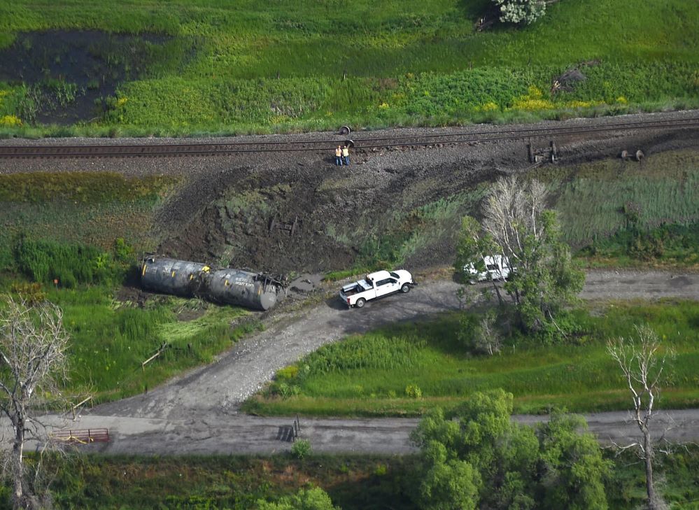

This photo, added to the original article later, would seem to show a car derailed on land, but it is not clear if it is on the east or west side (the train was westbound):
