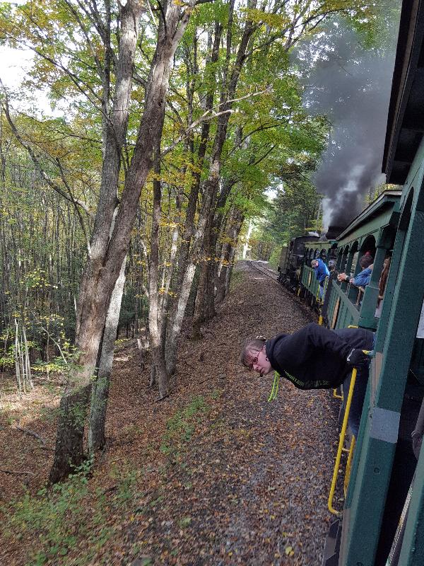

Last month, I had the privilege of riding the Roaring Camp & Big Trees Railroad in Felton, CA. We rode behind a narrow-gauge Shay locomotive up steep grades through an never logged section of Redwood forest. Having ridden the Cass Scenic Railroad many times, I noticed a couple of differences in their operating procedures.
First, the RC&BTRR train began with the locomotive in the lead pulling the train to the first switchback, then pushing to the second switchback, and again pulling to the loop at the top of Bear Mountain. Cass does the opposite with the engine pushing from the beginning, pulling between switchbacks, and pushing for the final destination.
Secondly, the RC&BTRR used the train air brakes to descend from the steep mountain grades. Cass has brakemen (OK, brakepersons) that activate the passenger car brakes manually. There are white dots on the wheels which the brakeperson must check frequently to make sure the wheel is still turning to prevent flat spots. This leaning way out looks pretty dangerous to me.
Anyway, does anyone know if each railroad has a reason why they do things the way they do, or is it just a case of "that's the way we've always done it"?

Good questions Roger.
I myself visited Cass for the first time about 3 weeks ago and was definitely surprised to hear that they use the handbrakes on the cars to control the train speed. I cannot tell you why they use the handbrakes and not the air brakes and I agree with your observation that it seems dangerous with the brakeman hanging out checking the wheels, but they seem to have been doing that a long time.
I have a good friend who used to work there as an engineman. On his first trip up to Whitaker he made a set on the train prior hitting the grade. He made the set in order to keep the slack stretched and prevent it from bunching up as the train began to go up the incline. He was promptly told by his conductor to "never do that again" upon arrival to Whitaker. So who knows when it comes to Cass.
I was told on my trip that they place the cars in front of the locomotives as a safety precaution. I figure if something were to happen with the train the engine would be there to at least slow or stop any uncontrollable movements down the steep grades. That is not an official statement just something regular visitors of the railroad told me.
