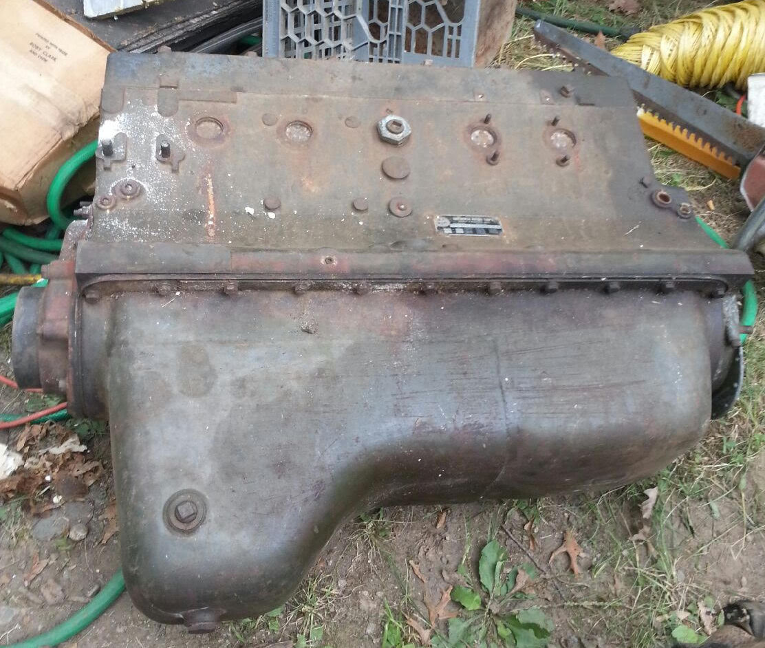

The bigger number looks like a casting number. Continental was good at putting tags on the left side of there engines, but not all. And anything military is up in the air. Can you post a picture? Is it overhead valve or flat head? Does the distributor come out the top of the head, side of the block, or off of the front cover. Does it have a mag or distributor. Picture would be best.

At this point the crate is long gone. However, if it pleases the court, I'd like to introduce exhibit A;

There's a possibility that it might be a non turbocharged light aircraft motor. Sometimes you come across one without the gearing for the propeller drive. They're mighty fine motors for small airplanes.

What's on the tag? Continental made a very wide variety of engines, the data tag has a wealth of info.

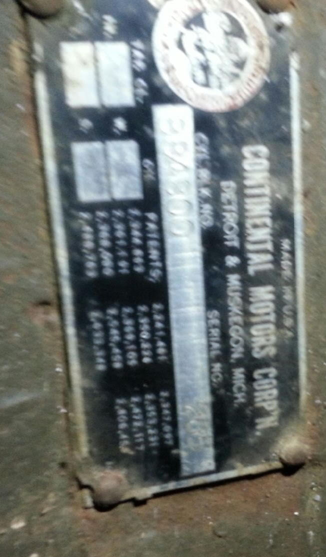

That's just it... Other than the 884800 and the Serial Number, there's nothing else on that tag. Which begs another question; could there be a tag on the other side? I'll be totally honest, while I can toss a furnace around with a bit of effort, flipping that motor over is way out of my weight class...

A closeup of the tag would help.

Hopefully this helps... Sorry that it quality picture in advance.

By chance, it doesn't have "RED SEAL" cast into the side of the block. Looks about like the standard industrial 6 that was used in many forklifts and other equipment. I want to say they were in the F series of engines.
 Post subject: Re: Riddle me this; Continental Straight 6
PostPosted: Wed Aug 12, 2015 1:23 pm
Posts: 367
A little bit of cross searching shows that it is most likely a 4 1/4 bore, 4 7/8 stroke flathead six sold to Clark Equipment Co.
