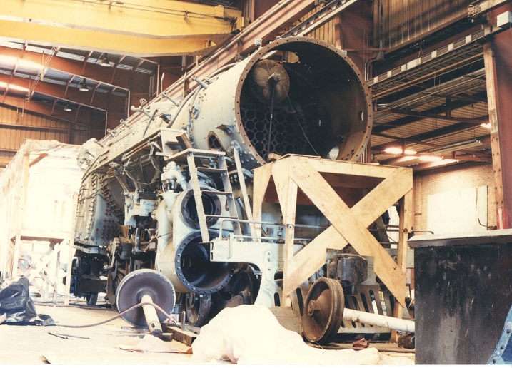

Here is a photo taken during her last overhaul in 1988. The boiler patch was applied at this time. Because of the patch she missed pulling specials during the Democratic National Convention which was held in Atlanta that year.

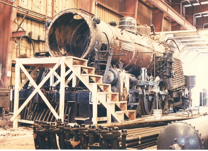

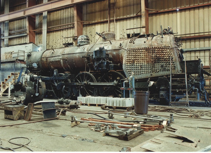

2 more from 1988.
File comment: On the other side of the shop sat 290 undergoing its overhaul. She was running a year later.

File comment: As you can see there were many flexible stay bolts on her side sheets. Panning from the smoke box back the first ring of rivets is the flue sheet. On the bottom of the boiler tube between the smoke box and that rivet ring is where the patch was placed. There is a speck of light in the photo that is part of the hole. The outer piece of steel ran from the smoke box, under the sheet for about 2 feet on the pressure side. The flue sheet rivets in the area were removed and then reapplied through the outer patch so that the boiler tube was sandwiched between the sheet rim and outer patch. Patch steel was placed inside on either side of the flue sheet again sandwiching the old boiler tube material.
