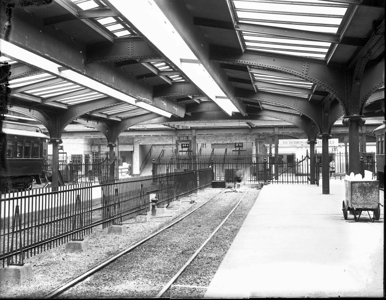

This view of the track involved, circa 1915. Very little has changed from this view.
 Post subject: Re: Hoboken Terminal seriously damaged in commuter train cra
PostPosted: Thu Sep 29, 2016 1:24 pm
Well, until about 0900 this morning.......... since that time it looks as if a commuter train failed to halt and ran past the end of track up onto the platform, taking out some of the roof supports.
