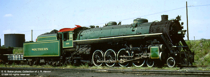

Modelers didn't assume the wrong thing, it just depended on shop practice. My thought on this is that one of Southern's shops used this practice and some modeler somewhere assumed it meant that every shop did it.
File comment: There are no preserved mountains, so this is an original color photo from before the preservation era.
