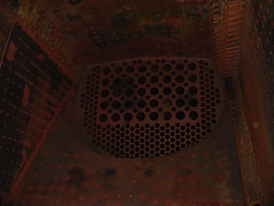

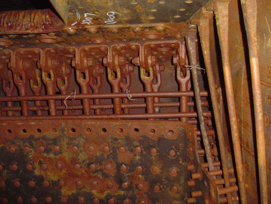

There is still hundreds of thousands of dollars of work needed on the boiler. 3/4 of the inner firebox sheets need to be fabricated and installed along with most of the stay bolts. The roof sheet need replaced, the reason why the project was suspended a few years ago. And there is the issue of the steam dome patch being fit for service with welding done to the patch after it was repaired and heat treated.

Have to love the "good luck" scribed on the "new" back head. That photo really underscores the complexity of the Belpaire firebox. Well at least in terms of the stay bolt array between the roof and crown sheet. Not much wiggle room (like none) to modify the pattern to address the 4:1 requirement.
And thanks for the insight on the dome repair. The Belpaire strikes again. The welded repair kept the job out of the complex transition (correction - Hip) to the firebox roof. I presume the hip is the reason the repair did not span the entire top of the third stage of the boiler from rivet joint to rivet joint with welding closing the seam like the patch put on RGS 20's boiler to fix the dent.
upon futher review of the photo of her boiler seen here http://rypn.org/forums/viewtopic.php?f=1&t=30294, the welded repair kept the repair away from a replacement of the upper half of the boiler course with the steam dome.
