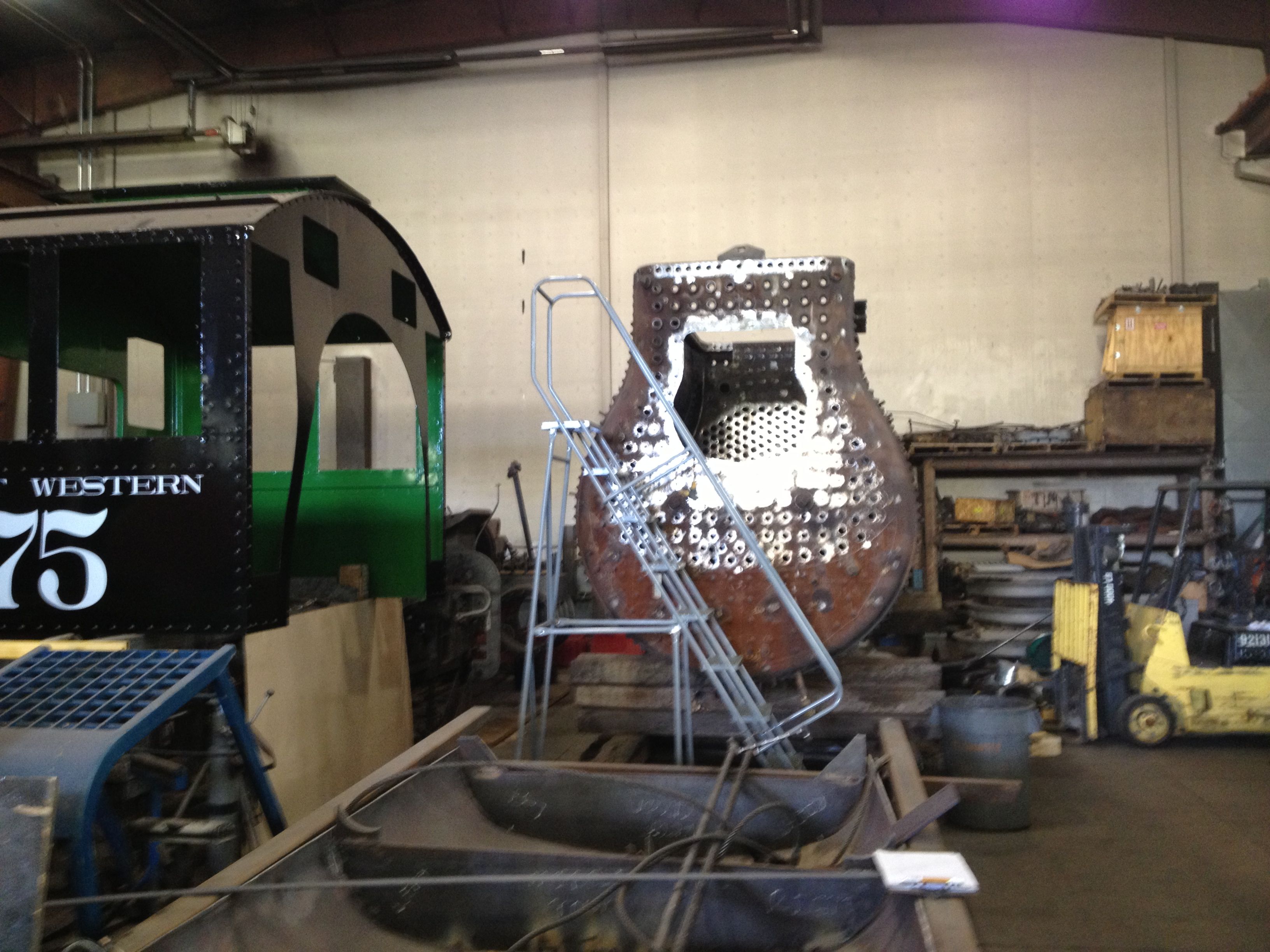

When I was up there last October, this was her condition. The cab is sitting crosswise o the frame.
 Post subject: Re: Great Western 75 status?
PostPosted: Tue Jun 18, 2013 4:13 pm
Dang! Thanks for the photo David! Wasn't she also getting a new tender frame? Or tank, either or.
