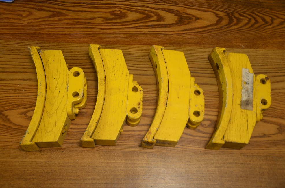

Are these the style kalamazoo brake shoes you are looking for?
Yes, these are the style of Kalamazoo we are looking for.
